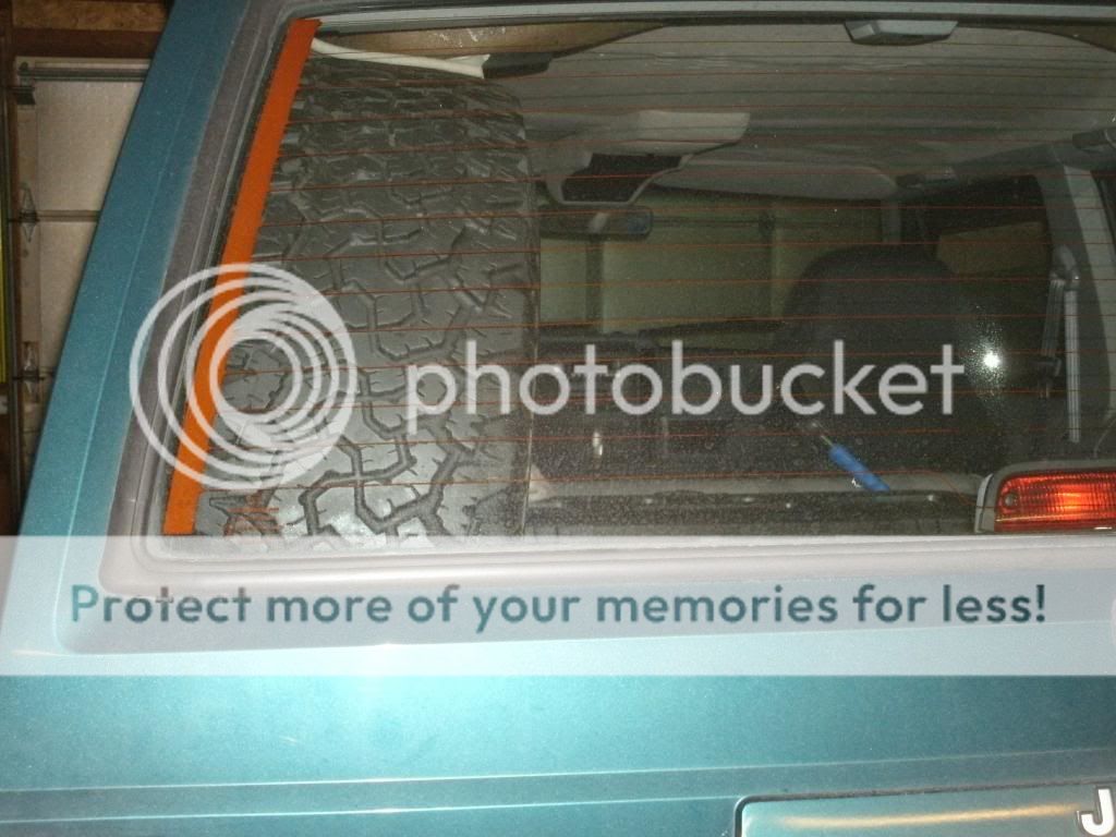

I'm thinking width might be an issue with storing a 31" spare in your stock location there. Here's a pic of a 31x10.5" spare in one of my XJ's. I was able to use the stock mounting sans pedestal and it clears the hatch glass by probably less than an inch. It does stick out past the wheel well though.

Here's a fresh one with the hatch shut that gives a better feel for the side squeeze involved. It's up against the sound bar speaker and makes a small blind spot to watch out for on that side. With your spare laying flat you might lose a little off the bottom but can keep full width field of rear view. Plus you'll gain a little cubby where the factory one rode.
I can't quite tell if that's diamond plate or a rubber mat protecting the top of your tools box, but it looks like a good mounting surface.
