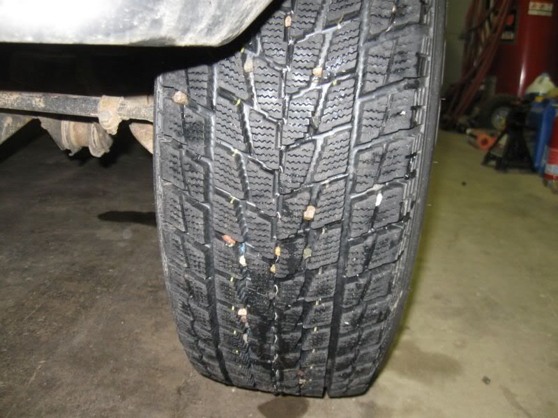

I've tried a few tires up here, I run BFG AT/KOs on mine, the wife gets every advantage possible so the Big-O ATs were taken off before the first hint of snow and I put some Toyo Open Country G-02 dedicated snow tires on her XJ in the 235/75/15 flavor. Our climate up here is such that ice is a big factor on our roads, thaw during the day then a quick freeze as soon as the sun goes down.
You can't beat the traction on packed snow and even ice that these things have. The rubber has ground up walnut shells in it, almost like little studs, after I go 33" KM2s next year I'm getting a set for mine.

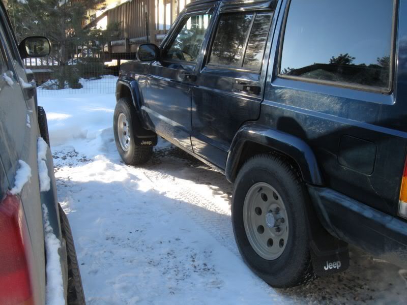

OK here's where the purists are going to get sick a little. Nothing ruins a wife's day like driving over 5 miles of wet, slushy dirt roads into town then getting out of her vehicle only to get her clothes muddy with all the gunk on the side of her vehicle.
SOOOOO, I got her . . . . . . . . .
Yes those are mudflaps, no I'm not turning in my man card, anyone who doesn't know the old saying when the wife's not happy no one's happy should learn it. I have to add a bit to the bottom of the front ones but so far they're working pretty well, and they say "Jeep" on them so they must be OK right?

I have Big O A/T's and have yet to have a problem on snow. And nice build.

Dave,
Where did you get the mudflaps at? Dealer?
I am thinking of getting a set for my XJ for winter. My Blue Jeep is pure white from road salt.
A set may lengthen the life of this thing some.
I may even pull the flares and add em so the salt doesn't get trapped

Jeepsareus Molded splash guards, $20/set plus shipping.
Attached with #12 sheet metal screws and washers into the flares.
I'll probably find some flexible rubber or something to add to the bottoms of the front ones to at least get the splash back past the driver's door.
Also available in No Logo.
