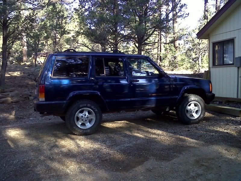

After driving my new to me '98 XJ she decided to get rid of the JK and buy these. An '05 Miata we found that was a vacation home car with 4800 miles on it and an '00 XJ with 120k on it. I wanted a Limited with ABS/242 combo but couldn't find one for her before winter.
BB/AAL with 235/75/17 Big-O ATs on it, ABS but no 242. I'm probably the first guy in XJ buying history to look under one and be glad to see a D-35 with tone rings.

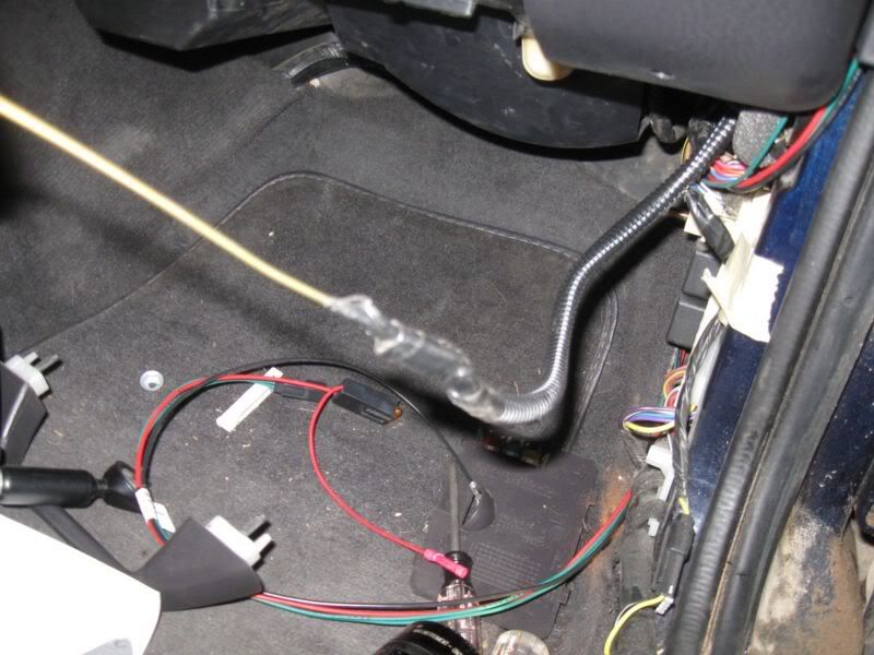

Wife missed the compass/temp feature the JK had, finding an overhead console is tough out in the sticks so I ordered a Gentex GENK20A Auto Dimming Mirror W/compass Temperature from Amazon. You can find these in most modern cars if you have junkyards near by, we don't.
Sensor under the front bumper
Wires for sensor through a convenient grommet.
Brought the wires all down by the fuse box, you can see the "fish tape" (coat hanger) I used to fish the wire from the sensor through the grommet and down to the rest of the harness.
Routing the wires from the mirror is simple, remove the visor clip and visor, A-piller trim needs to be pulled away a bit and access is easy.
The finished product. This mirror is completely self calibrating, the compass was working before we hit the highway a few miles from the house.

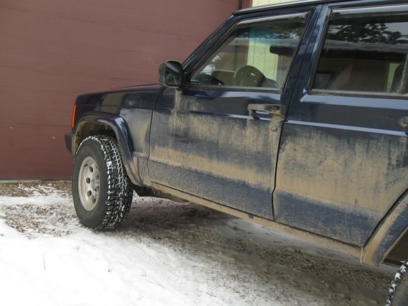

I've tried a few tires up here, I run BFG AT/KOs on mine, the wife gets every advantage possible so the Big-O ATs were taken off before the first hint of snow and I put some Toyo Open Country G-02 dedicated snow tires on her XJ in the 235/75/15 flavor. Our climate up here is such that ice is a big factor on our roads, thaw during the day then a quick freeze as soon as the sun goes down.
You can't beat the traction on packed snow and even ice that these things have. The rubber has ground up walnut shells in it, almost like little studs, after I go 33" KM2s next year I'm getting a set for mine.
OK here's where the purists are going to get sick a little. Nothing ruins a wife's day like driving over 5 miles of wet, slushy dirt roads into town then getting out of her vehicle only to get her clothes muddy with all the gunk on the side of her vehicle.
SOOOOO, I got her . . . . . . . . .
Yes those are mudflaps, no I'm not turning in my man card, anyone who doesn't know the old saying when the wife's not happy no one's happy should learn it. I have to add a bit to the bottom of the front ones but so far they're working pretty well, and they say "Jeep" on them so they must be OK right?
