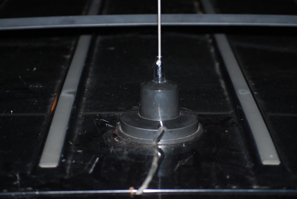

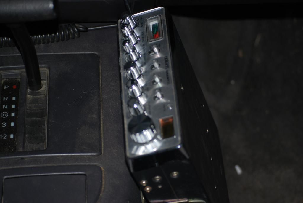

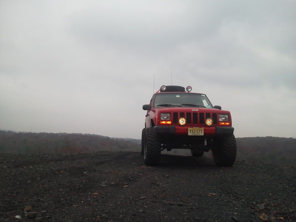

i have my CB just stuffed between driver seat and center console. and the antenna is just on the roof in the middle of my spare.
hard to see but its there.

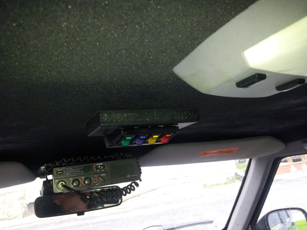

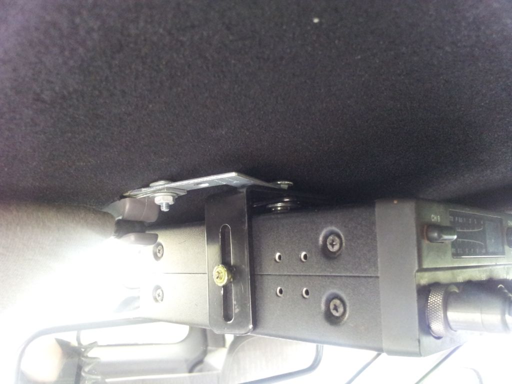

Mine's mounted between the visor's as well. I used the visor clip mounts though and just extended an L bracket from the cb mount to the visor brackets. Worked like a charm.

Just went out to snap a few cell pics for ya. I think I paid $3 or so for the L brackets
Definitely seems secure, hasn't budged. All my wiring is run between the headliner and roof then so it's out of the way. Was alot easier doing all of that at the same time I was bedlining the headliner.

I like your idea I've always liked the idea of having my CB on roof I work on an ambulance and that's where ours is mounted

Nice. Yeah, the location for the CB & switch panel were influenced by our firetrucks...been running fire/rescue 22 years now and ambulance as well off & on during those years. I like the CB being up & out of the way where it is. The XJ just doesn't have a lot of mounting room on the dash or center console for stuff really.
