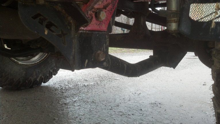

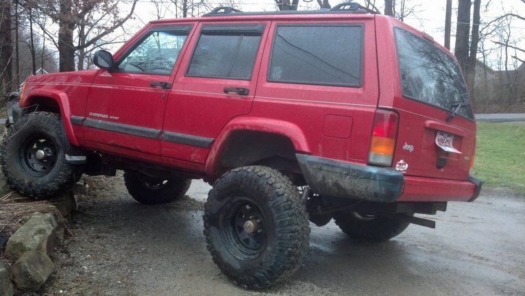

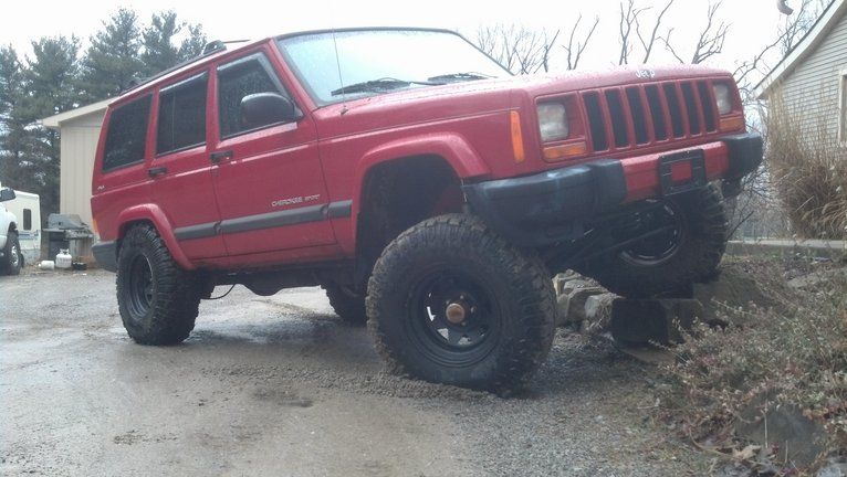

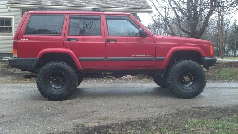

Hey guys! My name is Colton and I'm 18. I've been wanting an XJ for a longg time now and I finially saved up for my first one. It is an 01 XJ RC lift on 31 Trxus's. I love this XJ to death. I am using this as my DD but I also plan to wheel it all summer. Therefore I have some questions.
I know my Jeep has an RCX or a Rough Country lift, but I am unsure of the size. I believe it is a 4.5" because of the radius arms, the drop bracket, and the tcase drop (all of which comes with the 4.5 RC lift) but it doesn't seem to sit as high as other XJ's I've seen with a 4.5. Also, my tires rub like a mofo when I flex, and this is no good because where I am going to wheel, I am going to need zero rub with alot of flex. I'll post pictures up and please tell me what you guys think. I'd really appreciate it!

I'm kinda thinking it's more of a 3 inch lift. Not really sure though.

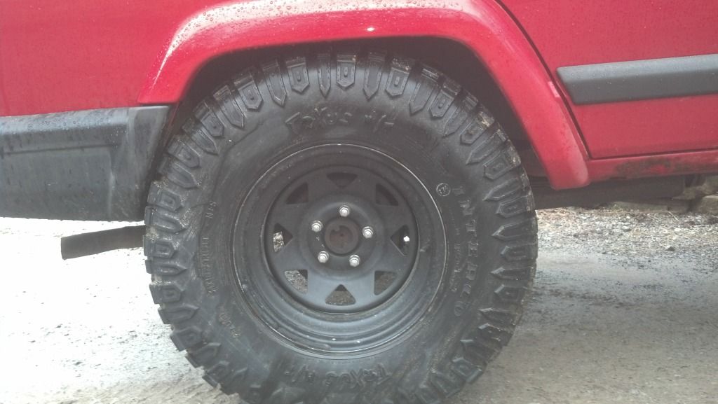

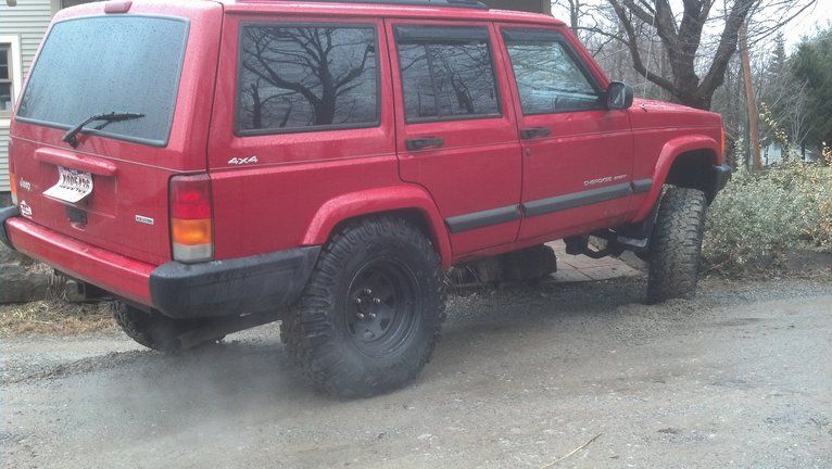

Now, you see where my back tire rubs the back of the fender well? I've been looking on how to trim that but I havn't had luck. Could anyone steer me in the right direction as far as pictures/links/etc?

Don't have pictures but it's called cut and fold. If you look at your rear fender Wells there will be small indents..those are pinch welds and if you cut them your going to have a hole into your Jeep. You have to cut in-between them and then pound up the parts you cut with a hammer. Try searching rear cut and fold thete might be ones with pictures.

Search for cut and fold, thats what most people do. Also if its not done already you need to bumpstop the front and rear even after you trim, and extend your brake lines if its not done already also
You can ditch your rear sway bar too if its still on

Those aren't radius arms, they're lower control arms. You'll have four links up there connecting your axle to your chassis.
Looks like a 4.5" lift because of the drop brackets on the LCAs. That lift will or has sagged. The arms in your photo, behind the front tire - are they parallel to the ground between the axle and the bend? If the bend is lower than the axle mount end, it is really sagging. In off road situations, those lowered mounts will hit on every rock and they can weaken the whole structure of the mount mounted to the mount mounted to the unibody.

Based on drop brackets and control arm angle, it is definitely a 4.5" RC lift.
