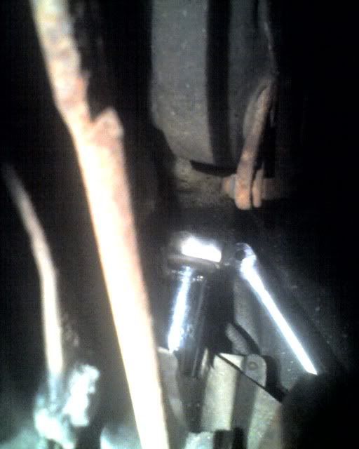

Originally Posted by compcrasher86 View Post
I just found the friggin 4wd switch while I was messing around under the Jeep. Jumped the connector and let there be light! the 4wd light came on for the first time ever! Haha So using a swivel socket wrench and a 7/8 deep socket (damm I love having a full socket kit) I was able to fit in this tight little spot:
and pulled out this little bugger
and with some mini alligator clips and a digital multimeter from my electrical engineering toolbox I verified it as not working. I tampered with it a bit and got continuity for like half a second but I've determined this thing is SHOT.
I would love to pick one up from a junkyard but all of the XJs there have their wheels removed so I can't get under one unfortunately and it costs $20 for them to lift it and put it up on stands to get stuff from underneath...
Soooo, where can I buy one of these, I'm looking for a 4wd switch for a 231. Looks pretty simple, just a ball that gets pushed in when you're in 4wd by a piece of metal.
I was able to fit in this tight little spot.

I just drove 5 minutes over to autozone because a birdie told me they have the 4wd switches as a universal part but I got there at 8:01... and apparently they now close at 8 and not 9. I asked the guy locking up the door if I could grab it real quick and he said nope, company protocal !@#$%^&*&^%$# Well I wasted some gas in my little frenzy. I'll pick it up tomorrow after classes
