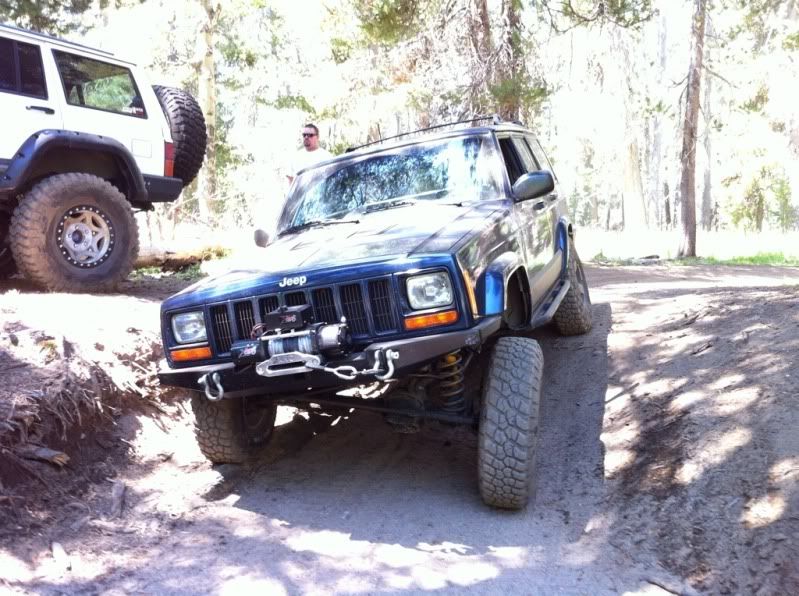

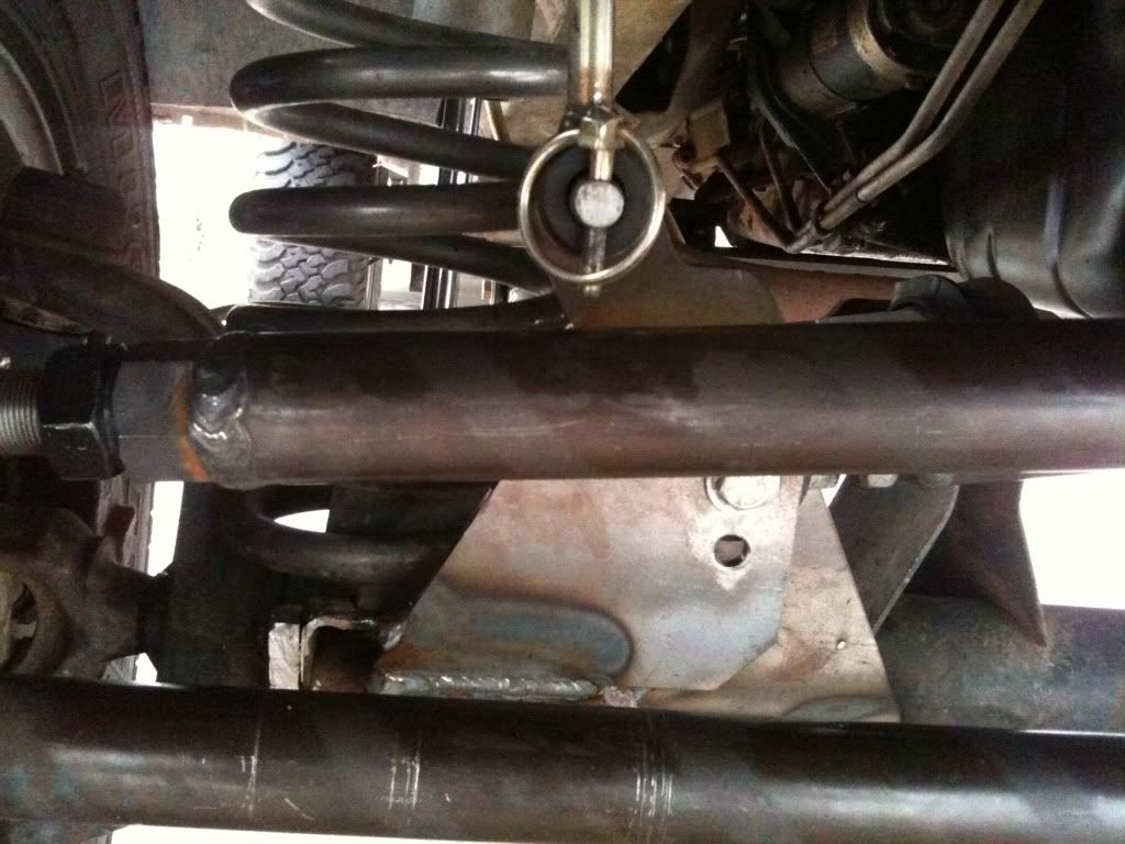

My favorite upgrade by far.

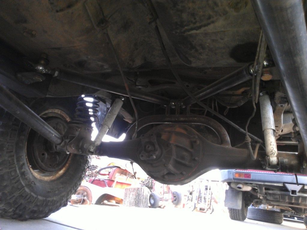

bad cell pic but double triangulated with 3/4 heim, 1.5/.188 dom uppers and 2"/.250 lowers with 3" ballistic joints. This was my mock up and i burned it in and it was amazing. Its getting some changes and stretch now that im rockin the small block!
edit: i didnt use those shocks just tacked on some beaten camaro shocks so the axle didnt stay on the ground when i put it on the lift to burn the tabs in lol.

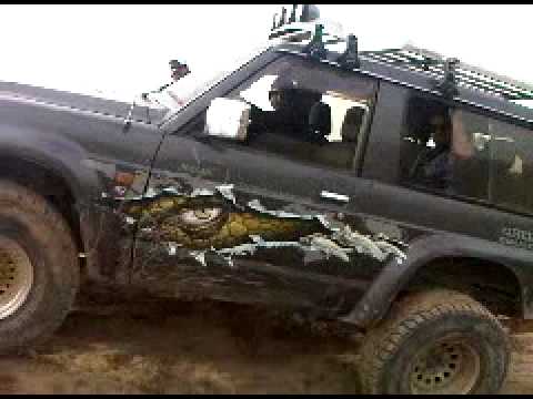

Added vinyl decals on my jeep to give it a sporty look and make it unique. I found it very cheap indeed.

Is that a shortened 4 door or just a wierd picture?

Looks like a dodge raider or Mitsubishi Montero to me
