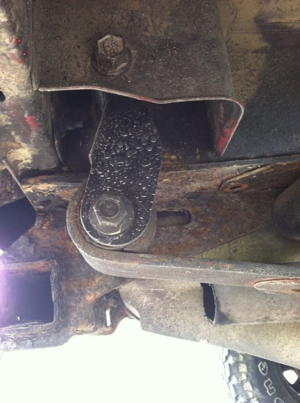

I didnt have time to go hit my loading ramp to see i the improvements, before the rear tire lifted when the front was at 31" with the forklift. The ride is better, not like everyone else says but that could be because my shackles were not completely straight. Where the shackle bolts now it is hitting the box. I dont want to move it back a hole because that almost where it was before i put the relo's on. So either a boomerang or a little longer shackle. Any ideas? Oh it also brought my *** end back up! Woo!!

I think you will just need a longer shackle and then trim the bracket for clearance. That seems to be the ticket to making the relo's work from what I can gather. These are definitely on my list.

My idea is to get some ranger shackles and cut away. Im thinking ill have my clearance and decent droop. (Got the ranger shackle idea for you haha) does autozone sell them?

Advance Auto had one in stock and I had to order the other (came in next day). I used my buddies discount but even without it they are like 20 bucks a piece brand new. They are boomeranged for clearance and give about an inch of lift over stock so a lil over $40 bucks is still cheap compared to other brands. And they literally bolted right in.
I think they would work good with relo's (part of why I got them). Id run em, pick a hole and hack away the ones behind it.

Thanks man. Those iron mans project posted really have my eye, reason bein because they a small all the way down the where they bolt to the leaf. I dont think id have hardly any clearance issues with those as a reg shackle.

True.... I wonder if i could build one with a jj that bolts in the relocation bracket instead of a bushing.
Edit: talked to someone who opened my eyes and not my head on this. It can be done and would give awesome flex, but would be bery unstable and would twist the leafs at the front hanger. No bueno!
