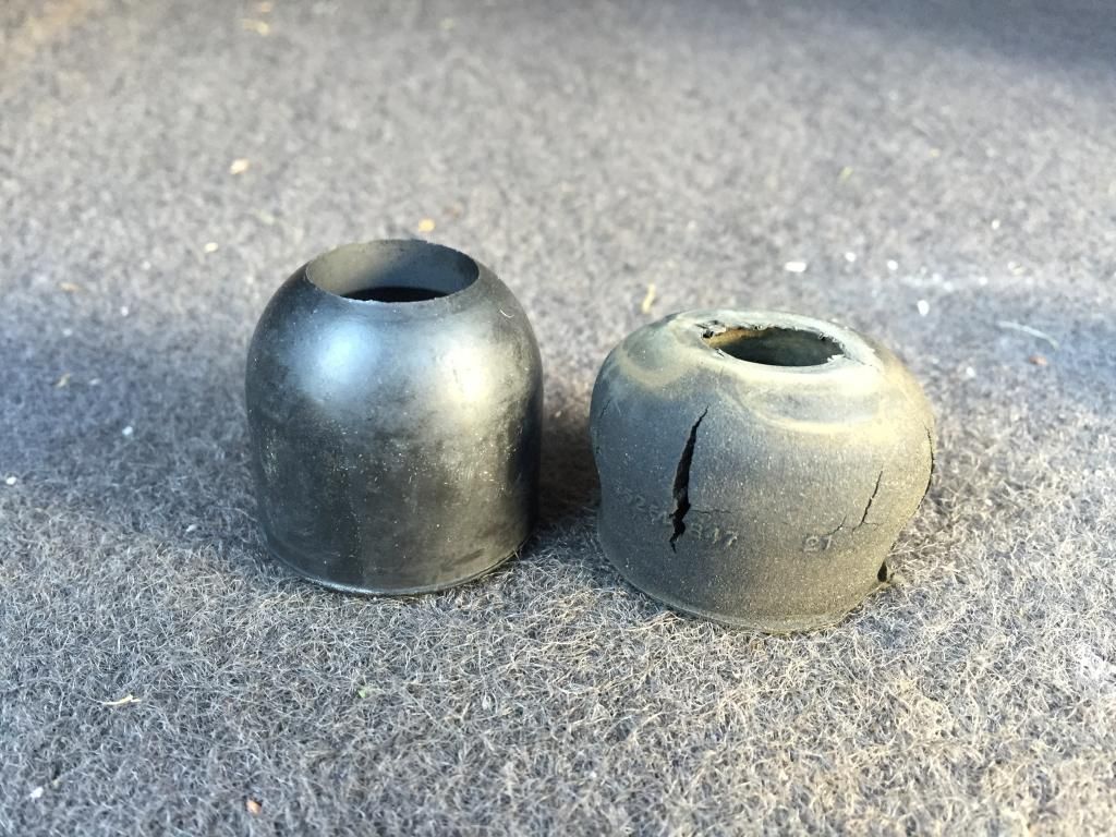

REAR HATCH - BUMPERS & SEALS
There has been an annoying rattle coming from the rear hatch ever since I got it. After listening to it from the trunk while my wife drove around - I could see the hatch was actually moving in and out a bit. Once I opened the hatch - I could see that both the weather striping and little bumpers were basically rotted away and not allowing the door to seal properly. I ordered both parts I needed from Quadratec and installed them in about 15mins.
While I was back there - I also replaced my hatch struts since it would slowly drop on my head. Not much to show there, but I got the struts pretty cheap on Amazon:
http://www.amazon.com/gp/product/B00...?ie=UTF8&psc=1
RATTLING GONE!
New vs. Old
Bumer and weather seal
