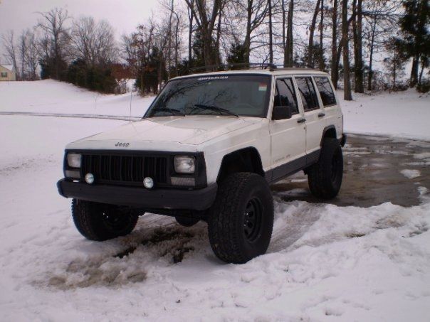

I had under 1500 in the white '96 up there, so it wont be no problem to ball on a budget.
Why you gotta get rid of the 88 anyway?
