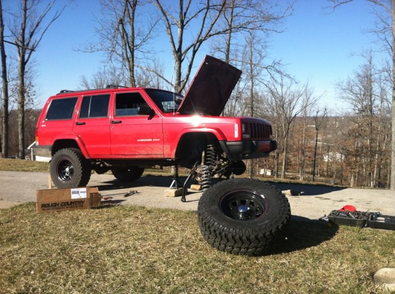

Got a lot done today! It was 60 degrees out, and I found some motivation.

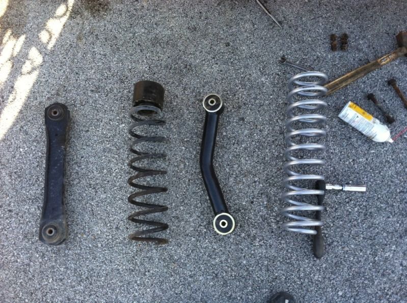

Began the teardown of the front end for my RE 4.5" coils and LCA's. Already been through the front end once, so no real surpises.
Up on stands:
Old vs new

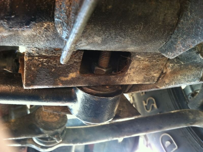

Redrilled the trackbar while I was there. Took 5 minutes. Measured, marked, punched, and drilled. I used a 3/8 bit and ran it through the trackbar bushing to get a straight shot at the back hole. I wallowed out the 3/8's holes slightly to accept the factory size 10mm bolt tightly. Broke original trackbar bolt the first go around, so picked up a nice grade 12.9 replacement. Side bonus, nut on the backside is easily accessed now.
