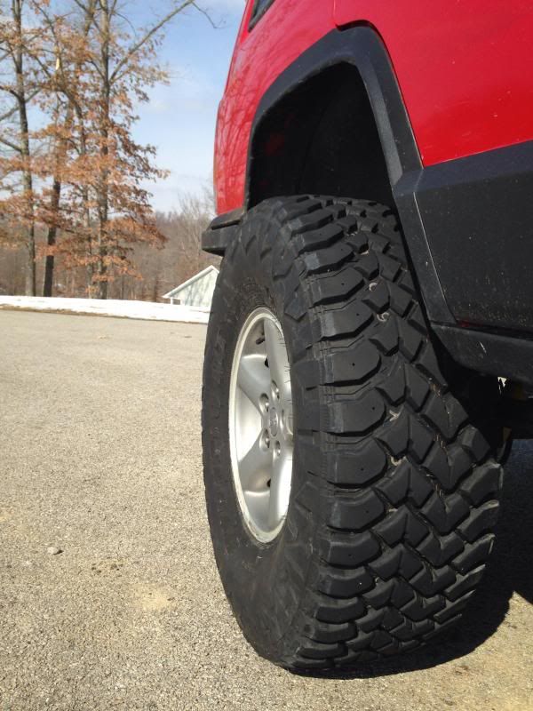

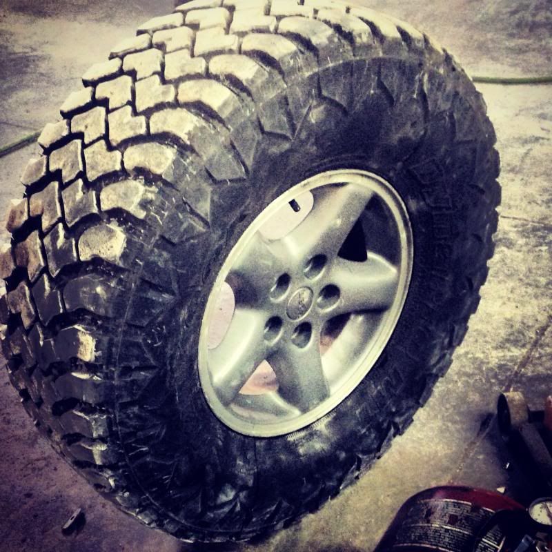

Also, ive got 3 Firestone Destination MT's of the 31" variety Im going to pull out of retirement to mount on the Cragars. Ill just order a 4th one to fill the set out. The others are 50-60% tread, they wear really well so Ill likely buy one or two at a time til I end up with an all new set. Keep from having a big hit at once and Ill have several good spares that way.
This is what they look like for those not familiar.

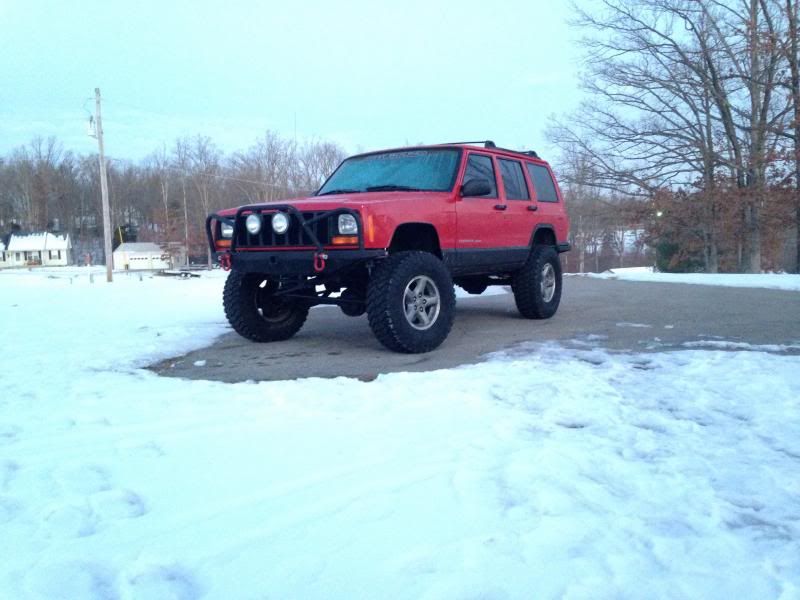

Haha just gotta find the perfect one. So far this is the cleanest and most mechanically sound Ive had so I plan on it to hang around as a long term DD so I can move on to other projects (namely building another Pony car). The Jeep will be getting things a little at a time as money comes available. All thats still sometime away though so its all Jeep for now.
Got dark on me so no good pics, but heres a quick phone pic:
Better pics later and hopefully a little wheeling soon.
