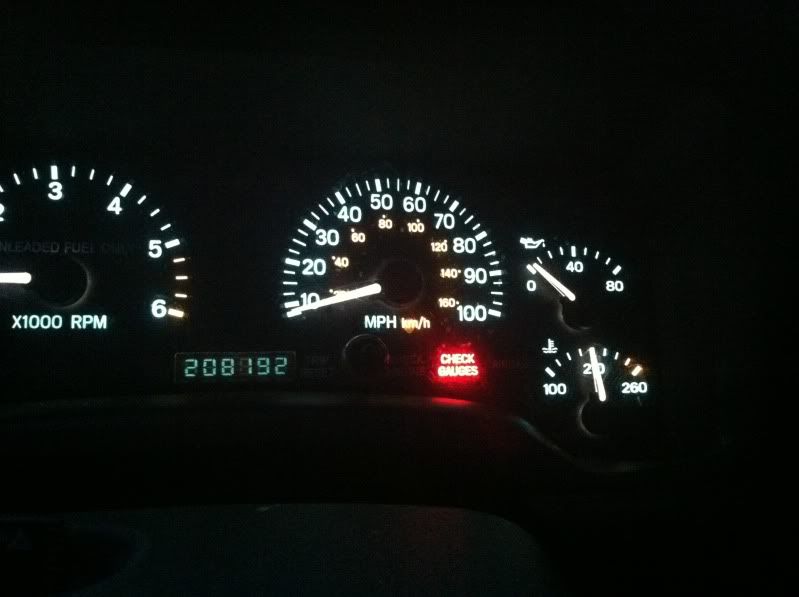

No major updates, but did encounter an issue recently that required some problem solving.
Like most of you, we've been dealing with unusual cold. Been hovering between -6 and 3 degrees for a couple days now. Drove the Jeep in that crap to work yesterday, and when I came back home I stopped in the driveway to see this.
Yikes. No oil pressure. Freaked me out, obviously but no odd noise or behavior from the ol 4.0. This wasnt improving on its own however, and knowing Im behind on an oil change by a good margin was not easing my mind.
I pulled it in the heated garage at the office after I picked up some Havoline 5w30, Mopar filter, and a new oil pressure sending unit after noticing mine was cracked near the nut.
Old oil was definitely nasty, and old sending unit snapped off at the plug like nothing when I went to remove it. Got fresh oil, filter, and sending unit in and all is well again. Crisis averted.

My oil pressure gauge has never worked. I've tried 3 new sending units and I still can't get it to work. Oh well

Since I have owned my Jeep, I have swapped out that oil pressure sending unit 3 times.
They seem to be prone to failure....

I cracked mine the first time I changed the oil on my XJ, due to it's location and the filter being on too tight.

Definitely seems to be a common failure. And Im with you S8NNG8, it is in a vulnerable place if you are trying to fight a tight oil filter.

Theirs a reason I went to a manual gauge
