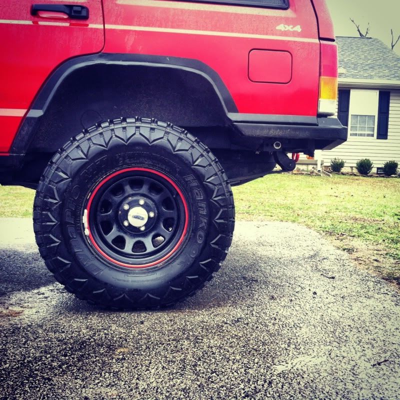

Daytime shot with bumper reinstalled.

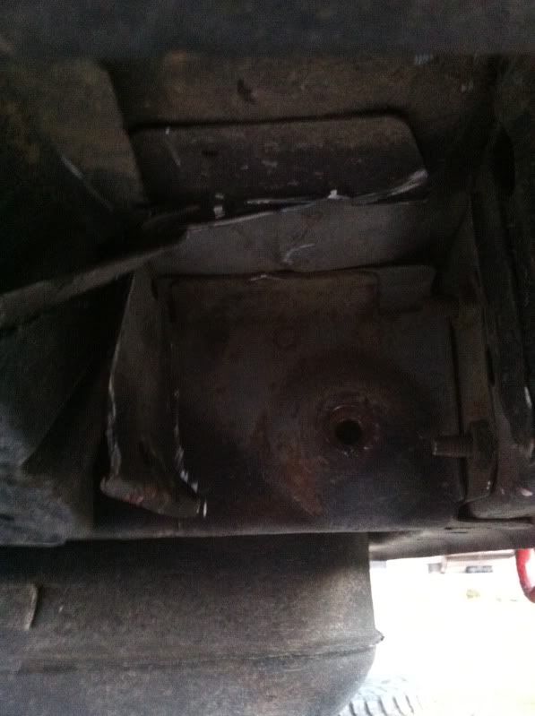

They look good, im just concerned with how they are against the floor. Id be worried about the floor giving out. granted all the weight isnt on the floor due to the nut strips but i still feel like its a possibility. Other wise looks good.
Where do you think your factory sheetmetal shacklebox mounts to?
The vertical load is taken up entirely by the section under the rail, the bolts through the floor mainly serve to keep the bracket from twisting out or in under flexing. I honestly feel this is probably the strongest shackle relocation setup out there, considering the other option is to add MORE leverage to an already thin shacklebox. That said Ive not heard of durability issues with any setup.

I agree that they can be nothing but stronger than the OEM box. 1/4 in steel vs sheet metal, 3 bolts in the frame rail, OEM shackle bolt, and two bolts sandwiching the floor.
The floor plate has more surface area on the floor than the OEM box did. So even with just that fact they would be stronger.
^^^ This.
I've never heard of anybody ripping the factory shackle box out of their rig - let alone any aftermarket relo kit.
The heaviest load IMO is probably the shear forces on the f/r spring eye bolts and the shackle bolt. I have yet to hear of these snapping either. Not to say it hasn't to somebody somewhere out there, but still, just say'n........
The HDE relo set-up looks damn stout! Nice job.

Yep, thats why I made sure to add that last part in there. I have NEVER heard of a torn out shackle box or anything of the sort. Even tho it looks weak (my cutoff wheel literally tore it out in a couple mins on pass side) it is more than strong enough. I didnt choose the no lift HD Offroad setup for the strength, I just REALLY didnt want lift. While I am super satisfied with them, I encourage everyone to correct their shackle angle SOMEHOW. All the brackets out there achieve the same performance, pick one and buy it. You would be cheating yourself by running a 90* shackle angle.
