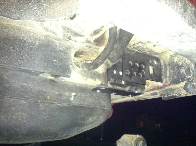

I was wondering how the no lift shackle relocators worked. That picture pretty much explains it! Hurry up and get this done! I want to see results.

Haha no goin back to stock for sure. And yea Muddy the factory setup has to be cut out entirely to utilize the new brackets.
I had to stop last night but I did manage to get the driver side dangling in place by one bolt just to give an idea of how it works.
I should mention having done the cut and fold makes this 100 times more accessible.

What is the oval at the back of the bracket for? Looking good so far!

It's for the stock shackle bolt

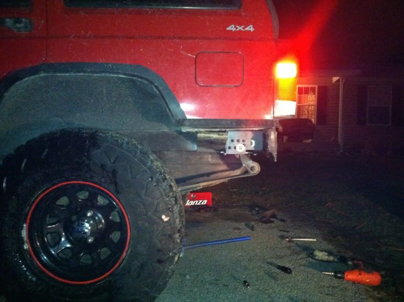

Off the stands and sittin at ride height.

Let me know how you like the shackle in that location. Mine is in the middle hole, but i may move it back in the future

Call me stupid but how does the bolt stay in there? It looks like the insode hole goes right tinto the "frame rail" not allowing a nut to go on and its not threaded. Am I missing something

I think you might have enough room fir bigger tires.

Time for a longer pair of shackles. And shocks to accompany the added droop.

Will do, I wasnt sure where to put it so I played it safe and started there.
The bracket mounts against the hump where factory shackle nutsert is, leaving a gap behind the new mounting holes for a nut and wrench.
Haha, 35's are next, just runnin thru these 32s while I build everything up.
Shackles are probably pretty ideal, they are Ranger shackles, roughly 1" lift shackle. Shocks would be a good idea, but Ill see how they do. They droop down pretty far.
