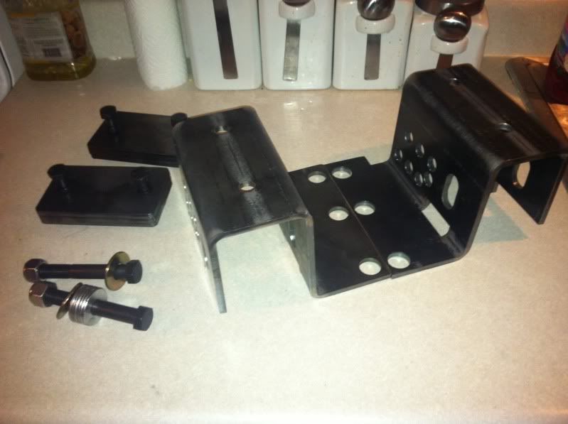

Oh yea almost forgot
I cant begin to describe how heavy such a small box was.

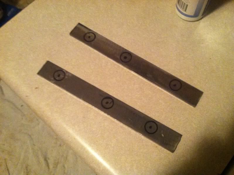

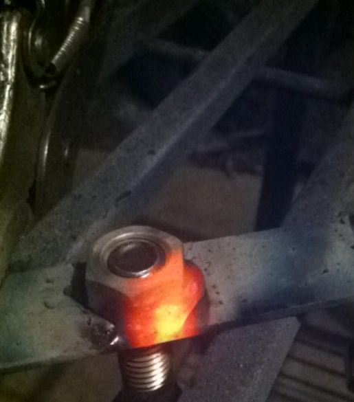

No real progress yet, but I did get "something" done. The HD brackets require being mounted to the hitch location with 3 bolts, plus an additional 2 through the floor and 1 in original shackle nutsert. The hitch bolts are problematic for me because my hitch was rusty, and I broke almost all the bolts off in the OE nutstrips, so I removed them. I am going to be redoing the mounts on my rear bumper to mount inside the rail with nuts welded inside down the hitch mounting holes. Unfortunately I dont have this done yet, and probably wont be able to until warmer weather or at least til its daylight at 5pm lol.
To combat this until my bumper re-do is done and fully tied in I whipped together a set of "mini nutstrips" just for the relocation brackets. Used the brackets as a template onto scrap I had laying around, the drilled and welded on nuts. Quick and painless, and with this out of the way all I need is a little free time and Ill be able to mount up the HD brackets.
Drill marks:
Quickly boogered on nuts:
Not having to pay money for nutstrips you will eventually discard: priceless.
More updates/pics on install as I make progress!

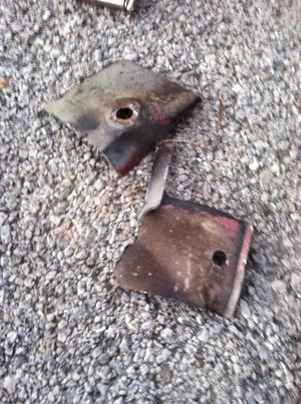

Well, put a little time in on the Jeep this afternoon. Pulling it off DD duty and driving the Corolla for a few days so I can put a little time in the afternoons on this every day til I get it done.
Started on the trickier side (drivers side with fuel fillers in way) to get it out of the way. Really have to get creative on grinder placement, but no turning back now!
