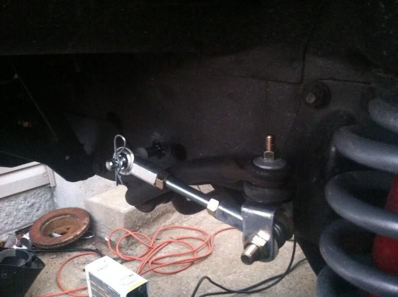

Here's what I did for "Disco Keepers"
No more Whiskey Tango zip ties/rope/wire holding them up when out on the trails.... My welds aren't the prettiest, but they hold up. (sorry for the dirty pics - this is post trail use - and a little more mud than should be up there for picture's sake)
1/2" x 2.5" hex head bolts, welded to my front tow hook brackets.
they're not there any more as i'm not running my tow hooks any more.
(its the tow hook brackets those are welded to)
Worked real good though.
Thats fantastic! That is EXACTLY what I had in mind. Great minds.
Only thing is, I too dont have those brackets, and my tie-in brackets for the Dirtbound bumper dont really land where I can weld the hanger to it. Ive been out here staring at it, having a beer and sorting out my options.
I can either:
A: weld plate steel to my tie in brackets, and bring the back off the brackets far enough to weld the hanger pin on. This will give me a good base to weld off of, and make it a removable ordeal so if something should happen to this rig (God forbid) in the future, it will make transfer of mods to a donor easier. Thats prob thinking too far ahead though.
B: find where I want the pin to go on the rail, then plug and stitch weld a small plate on that area to give me a solid welding surface to burn the hanger onto.
Either way will work I believe, A is a bit more "modular" of an approach, B is a bit more "its a damn pin, quit overthinking it" approach.
Ill have a few more beers and ponder this. I am open to criticism.
Thanks for keeping tabs on me over here NW99XJ, your input is always helpful. I feel plenty competent in most of the build projects I work through but there are times another set of eyes/opinions are very handy.

why don't you just weld a bolt onto the frame rail up and out of the way? Its not like these hangers will be holding a lot of weight, and if you ever get tired of it, just cut them off with an angle grinder

Thats kinda the plan, but I guess Im overthinking things. I just know I get rowdy sometimes and bounce this thing around. I just dont want the damn thing flopping around and tearing a hole in the rail.
I over engineer EVERYTHING.... gets me in trouble at work most times.
I just keep hearing the words of my old engineering professor in my head....
"Keep It Simple Stupid"
Really there's virtually NO force on the swaybar, and most of the mass is taken up by the bushing mounts anyways while its disconnected. Even with my crappy welds and a Home Depot bolt, my set up held thru numerous wheeling adventures. Hell....those damn bolts are STILL on those brackets. And I BEAT on em a couple times getting them out to do the bumper.

Thanks for all the insight everyone. Looked at it with a clear head this afternoon and noticed the rail is double layered in that area. I went ahead and welded the pins straight to the rail, seems plenty strong for the application. Ill get pics up shortly.

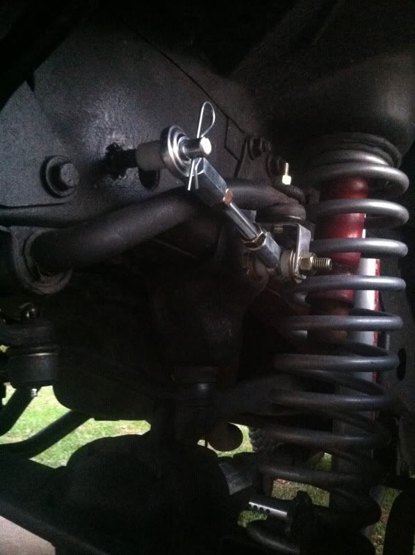

Hangers done:

professional grade! I think that setup looks better than my RC disco's
crockett07 is offline
post #893 of 2859 Old 11-05-2013, 05:00 PM
NW99XJ
Location: Gresham
Posts: 1,320
Nicely done sir....now go get 'em dirty!
I don't suppose there's much movement(flex) between the front of the rails, but if a person were to pin the discos up too tight, could it break them?
After looking at it I dont believe it will be an issue. Not much load on the hangers.

Heres a short clip of the disconnecting process. Pretty painless.

I may have missed it, but what type of threaded rod did you use for your disco's? (size/ type - zinc coated/ stainless?) 1/2" Heim's?
