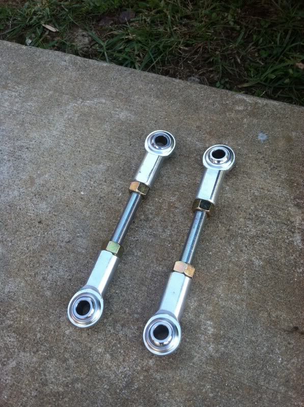

In other news, got all my stuff gathered for swaybar quick discos. Idea inspired by Weeder1's setup. Gonna try to make it my own by doing a couple things different, I basically want to make this as convenient and easy as possible. If all goes to plan, one pin per side will be all that needs pulled, then the links will be hung on new studs off the unibody rail to be tucked out of the way.
Ive gotta spend some time fabbing stud to heim brackets, among other things, but I hope to have it done by the end of the weekend. Will post pics as progress is made. Parts pile for now:

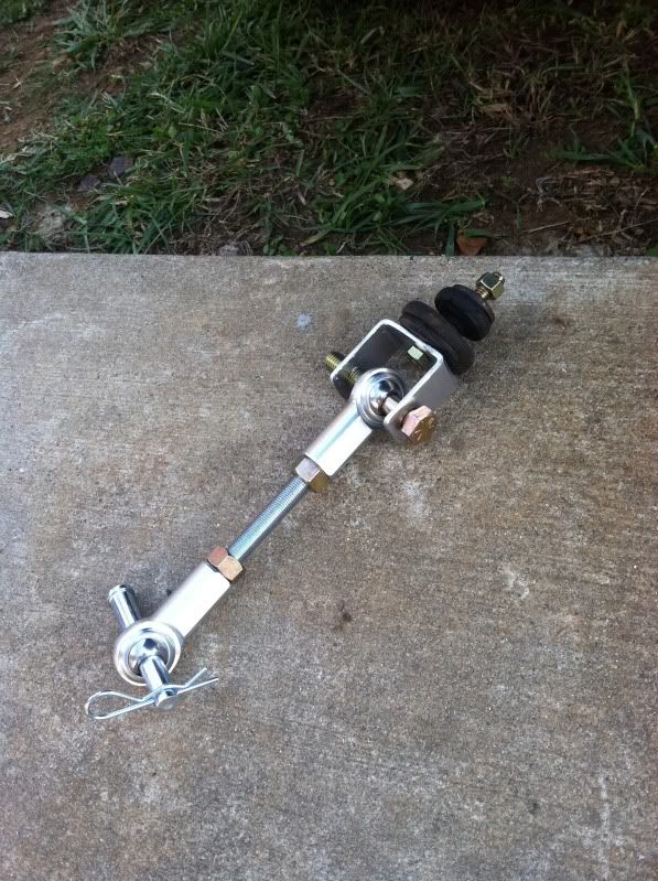

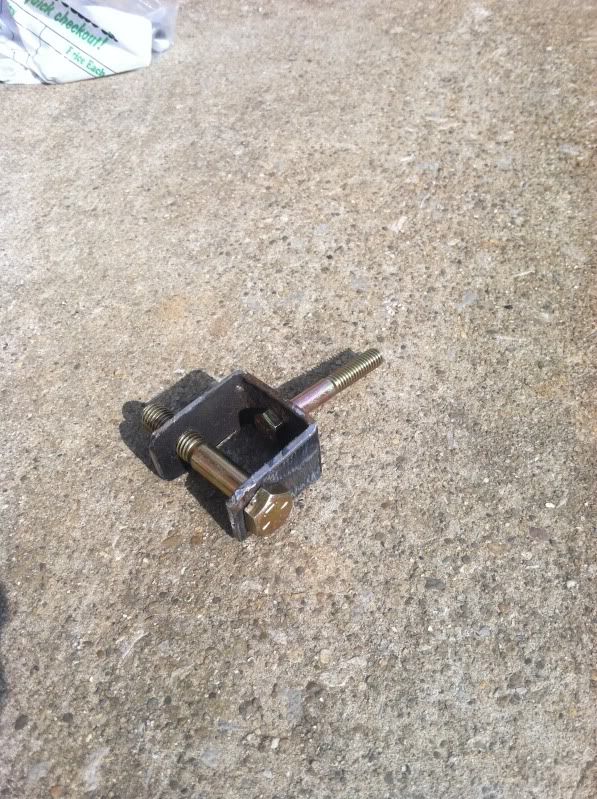

So I got a little done on the new swaybar link setup today. Started out by taking some scrap I had laying around and making brackets to adapt the stud style swaybar to the heims. Very simple to make. 3/8" grade 8 bolt for the stud and 1/2" grade 8 for the heim side.
Snugged them up and moved the swaybar where it needed to sit at ride height. Now I needed to know the eye to eye measurement so I know how long to cut the rod down. Looking like 7.5".
Links ready to go in:
Then went back, sanded and painted the brackets to make it look a little more legit and keep rust at bay. Gotta come with some spacers, and still got work to do on the Jeep itself, but this is pretty much done. You can get an idea of how its all gonna work in this pic.
Basically, ill be welding the pin on the lower side, and plating a small portion of the rail to weld another pin to. All ill have to do is pull one clip, swing the link up on the frame side pin and im disconnected.
However this is all Ive got done so far, natural the Jeep decided to halt my progress. The bolts on axle side wont come out, so Im having to cut them and drill through to 1/2".
Ill keep ya updated. When I get it done (assuming all goes to plan) Ill try and post a video of the disconnecting process.

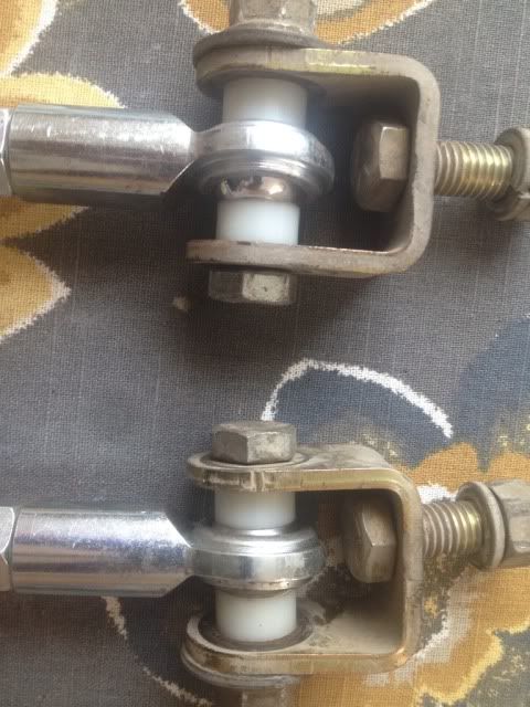

Just a suggestion, look into so spacers to keep the links from sliding around. They get noisy and clink and clank over everything.

The fabbed up discos look good but I have to say I'm feeling glad that's one less thing for me to have to mess with.
Very thorough work though dude - thumbs up!
