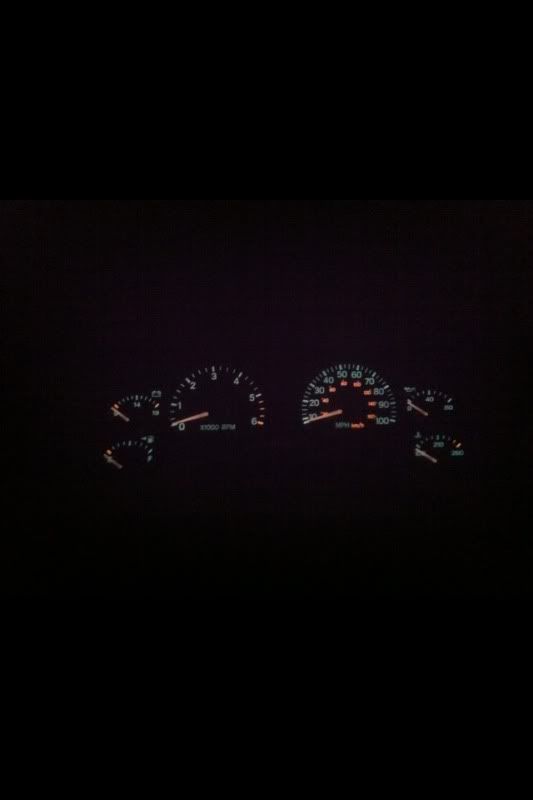

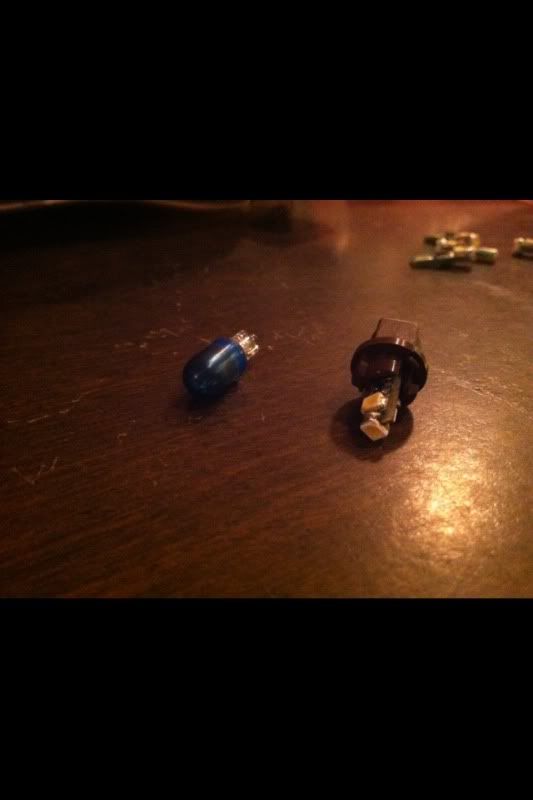

Well, got a tiny package in today, so Ill get on with it.
Boring, dull:
So I pulled out a ridiculous number of dash panels to get the cluster out.
Then traded out the incandescents for these wide angle LED's in Cool White (light blue color) from SuperBrightLED's. Super simple.
And ta-daaaaa.
Nice crisp gauges that keep the OE color scheme and look like something out of a newer model vehicle. Really pleased with the turnout, will be doing HVAC next.
Before/After:

post #849 of 2859 Old 10-28-2013, 07:12 PM
crockett07
1992 XJ Cherokee
Location: Lake wales
Posts: 1,012
The leds give it a nice modern look, I've thought about doing this before, I just haven't prioritized it yet
crockett07 is offline
And ta-daaaaa.
Before/After:
It turned out good!

Posts: 5,395
Originally Posted by MOBBiN View Post
It turned out good!
Thanks man! You were part of my inspiration haha.
Yea, really freshened it up a bit. I honestly didnt intend to do this right now, but I was on superbrightleds.com checking prices, then said oh what the hell and ordered. Was $20 shipped, so I could handle that, cheaper than a half gal of rum.

post #853 of 2859 Old 10-29-2013, 07:37 AM
crockett07
1992 XJ Cherokee
Posts: 1,012

post #854 of 2859 Old 10-29-2013, 08:04 AM Thread Starter
VegasGT
1988 MJ Comanche
Location: Leitchfield, KY
Posts: 5,395
Edited: I looked on the website and it brought up 3 different ones for my jeep. Which is preferable, how many do I need?
With yours being pre 97 Im not sure if the bulbs would be the same, but I used 74-xHP3 led's. They are wide angle, gave perfectly even end result with no hot spots.
These:
You can see color choices there too.
Edit: 97+ calls for 5 of these.

post #855 of 2859 Old 10-29-2013, 08:07 AM
NW99XJ
Location: Gresham
Posts: 1,320
QUESTION......Do they dim?
