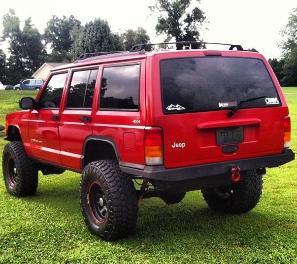

Looks like wheeling is on for this weekend. Busy week, so no time to get on the rocker replacement done but things have been so hectic with work and other issues lately I need to get this thing out for some fun/stress relief.
In case I **** something else up though, heres a clean pic to remember the body by haha.

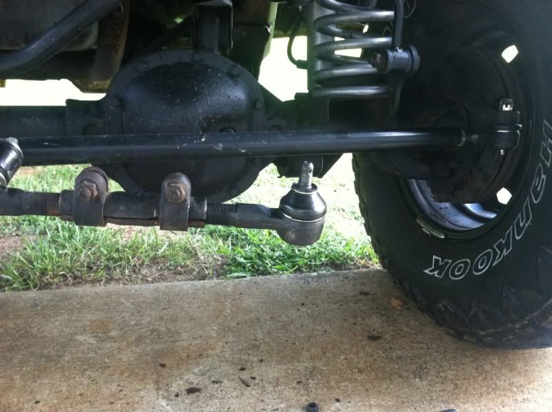

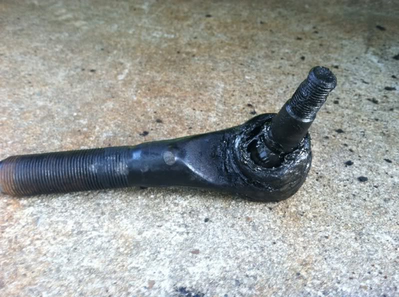

Boring, trivial update, but I got the TRE at the pitman arm swapped out. Old one was very loosy goosy.
While I had that out I shook around on the pitman arm itself and noted some chatter there, and I have fluid leaking around the seal there. Not bad enough to **** with now though, so I went ahead and put things back together.
Still got some popping/rattling type noise in certain situations, but better then before. Durango box upgrade in the future anyway so **** it.

What is your steering set-up? Tie rod looks stout in that last pic.
I've been looking at Crown's heavy duty linkage - draglink, tie-rod, tre's. Can be had for under $150 shipped. It's not the strongest out there but def beefier than stock and would probably suit my needs just fine. Still trying to figure out if it's just a V8 ZJ linkage set up though.
Also been reading up on the Durango box swap and between here and NAXJA the #1 complaint is loss of turning radius.
Thoughts?

Im running IRO's solid HD tierod. I think thats about as good of an option as there is in steering without going to a 1 ton setup. Its tough as nails, Ive scraped it, hit it, landed on rocks with it, no trouble at all. I still hate the inverted Y setup in general but the IRO rod was cheap and beefy enough to buy me some wheeling time til I man up and go WJ swap, crossover, and OTA trackbar.
As for the Durango pump, Ive done pretty extensive research and regarding the turning radius issue, Ive discovered mixed results. I read some people that do not notice a decrease, and some that do. Seems theres a theory out there that there may be an unknown variable in the box depending on how lucky you are when you find one. There is a well documented fix if you do draw the short stick on box selection, but it does involve opening it up.
Personally, Im going to see how long I can get out of this box (maybe add a cooler), but when it goes Ill just pick up a Durango box and see where it puts me. I will need all the help I can get in the steering department once I go 35s, so if I have to modify the box to get more throw, Ill cross that bridge when I get there. Hopin I dont though.
