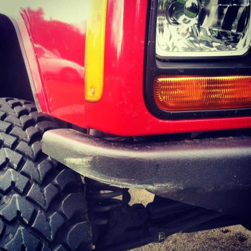

I also should mention that I owe the design crew at Dirtbound Offroad a generous thanks for making the bumper have rounded corners. In the same area that I received the nasty bruise on the rocker, I was under heavy throttle to pull up all the slick rock, and when I made the obstacle I was hurling my right front right into a tree. Coulda been a 2nd slap in the face (busted header panel woulda been no fun either) but I literally glided right off of it and got pointed back where I needed to be. Didnt even hurt the Duplicolor liner much either. Had I still been running the factory bumper or even an aftermarket without side protection I would have had even more work to do lol.

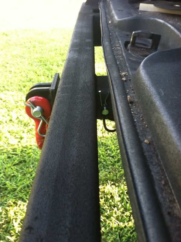

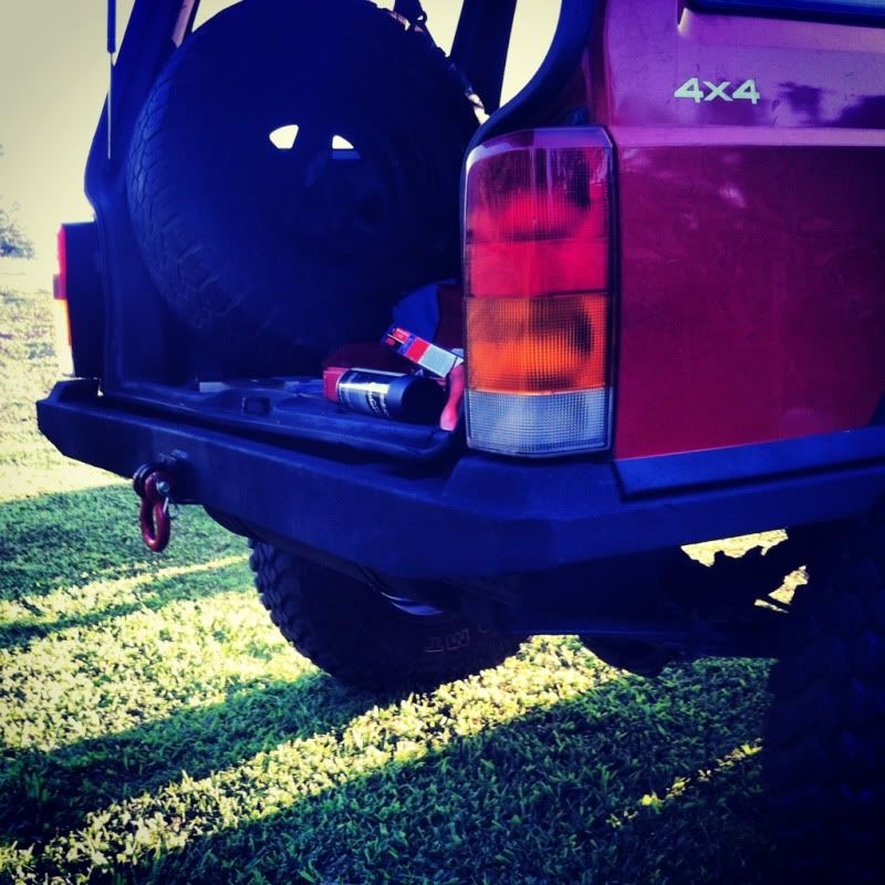

Ohhh noezzz. Someone cut a hole in my bumperrrr.

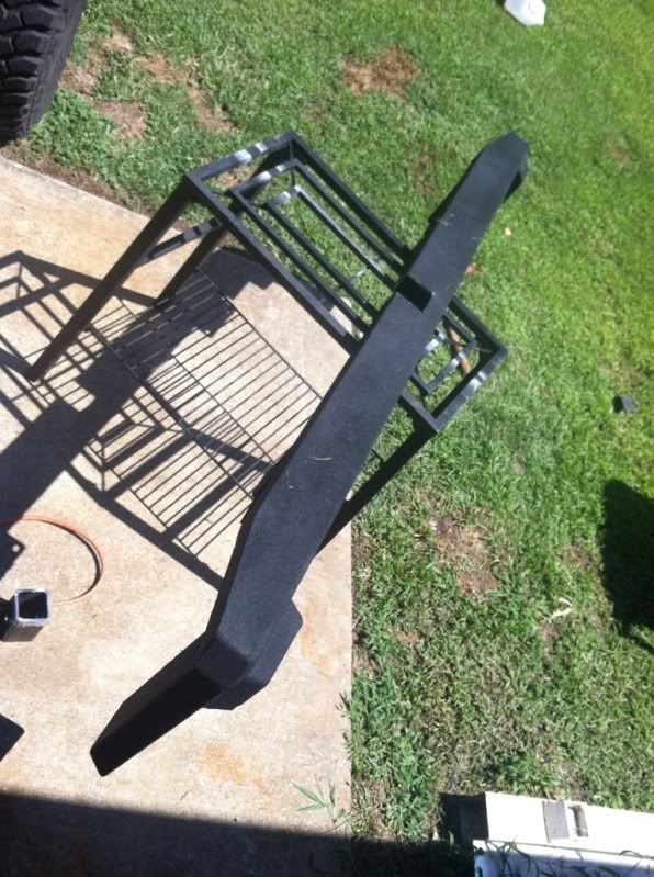

Made some progress anyway.

That bumper looks good!
