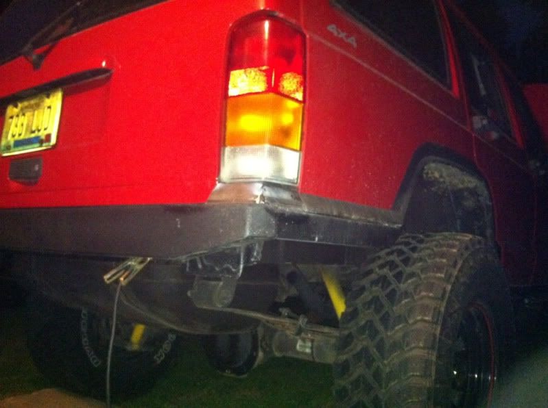

And this evening I caught a spurt of enthusiasm and started working on the tail light fillers. Since I wanted to incorporate some angularity here, I didnt get much done before I grew tired of measuring, cutting, grinding, blah blah. Terrible night pic, but heres the pass side mostly tacked in.
Will get better pics once Im farther along.

Spent some time this afternoon finishing up the passenger side tail light gap filler for my bumper. At this point Im not real sure how many hours I have into this thing, but the whole process has been really enjoyable. This is my first bumper build ever, and its been really rewarding to have a design in my head and watching it come to life one drop of sweat at a time. Hopefully I have the garage built by spring, I literally built the bumper in my backyard, weather permitting. Not ideal but its the hand Im dealt for now.
Anyhoo, heres a pic of the completed pass side.

Lol I kid, my *** is wore out. If theres anything Ive learned from this project its why pre-built bumpers are so pricey lol. I got a nice deal on the steel, so Ive only got about 95 bucks tied up in this counting consumables, but my oh my the time its taken me haha.
Even aside from the physical labor part, just mocking things up and getting the look I was after was a big time killer, not to mention my primitive operation Ive got here haha. This was built with pretty nothing but a 110v SMAW, a 4.5" grinder and a square. A nice 14" chop saw woulda saved a ton of time and measuring, but it all worked out. Kinda fits the relatively low budget, shadetree mechanic build theme. Except my spot doesnt have a shade tree haha.

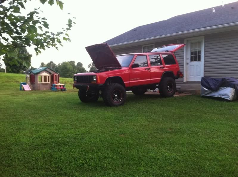

Got started on drivers side of the rear bumper this afternoon in between rain showers. Had a bit of a rough day so it was nice to be able to do some cutting and melting some metal, nice stress reliever. Built cardboard templates of the pass side taillight filler pieces to ensure a symmetrical bumper.
Shot of my current work space. We've been at the new house for a year and 3 months, I will not go a full 2 years without a garage.
