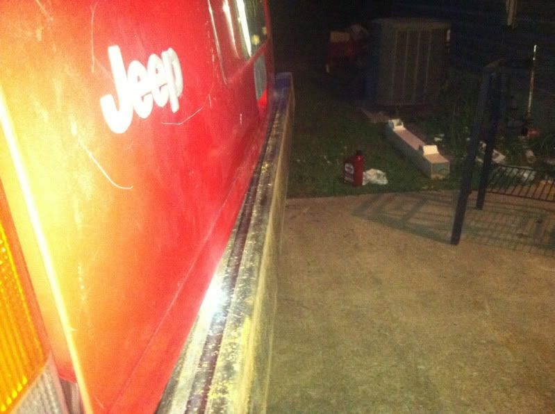

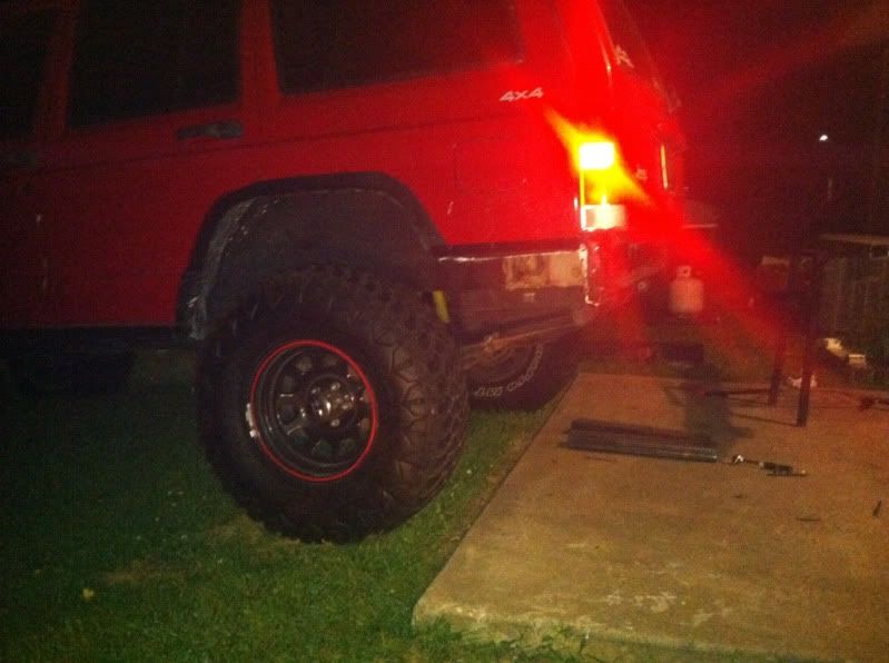

Started on the bumper, got the beginnings of it tacked in. Still a lot to do but you can kinda use your imagination at this point.
****ty night shot:

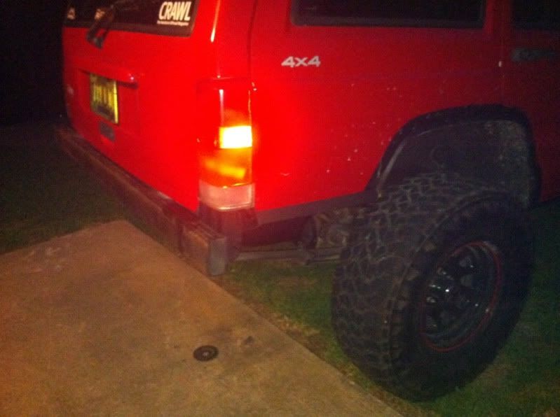

Got a better shot of the start of the rear bumper. Tried to get a good compromise of keeping it high and tight while still offering some protection if I back into something. Hope to have it mostly finished my the end of the week.

Lookin good. You gonna notch it at the frame and pull the corners in?

Aesthetically, I originally intend to pull the sides in to flow with the hatch. It just makes sense, but I know I could also benefit from the extra protection in the taillight area if I did not do this. With that said, Ive done about a million measurements to get the main tube to sit exactly where I want it. As is there are no gaps visible when looking down at it from above, and even at the sides it is still tucked in a good bit more than the factory bumper.
It looks a bit funky right now since its still a blank canvas, but once I get the ends angled/capped, side wings on, taillight gaps taken care of and 2" receiver integrated it will all really come together.

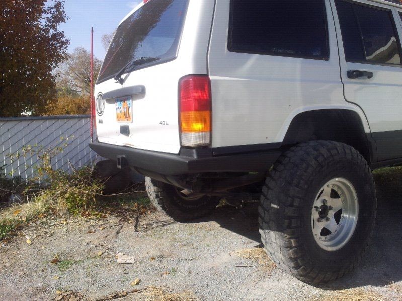

Heres one similar to my plan.

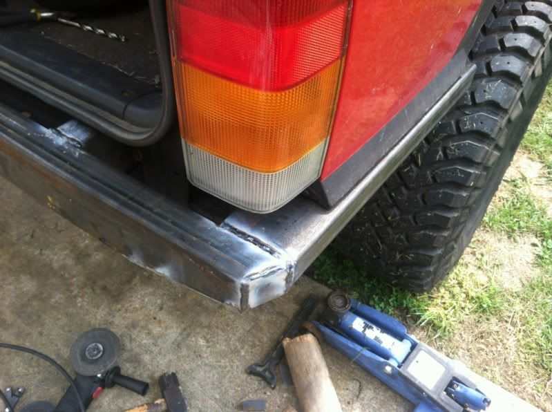

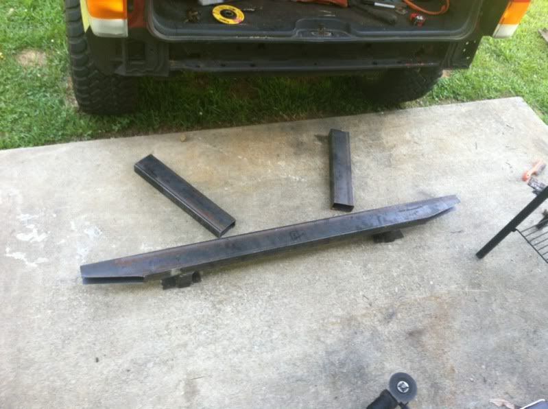

Got a couple hours of work in after work today. Burned in main tube to the mounts solid, cut the ends and cut off the beginnings of the side wings.
Also got drivers side quarter cut/boxed/sealed to prepare for building the wraparound portion of the bumper.
I have to say, all the writeups on the cut n fold had me expecting it was a big job. I honestly think it just sounds complicated with measurements and all that. This was by far one of the simplest things Ive done to the Jeep lol.
