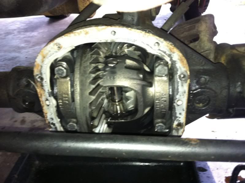

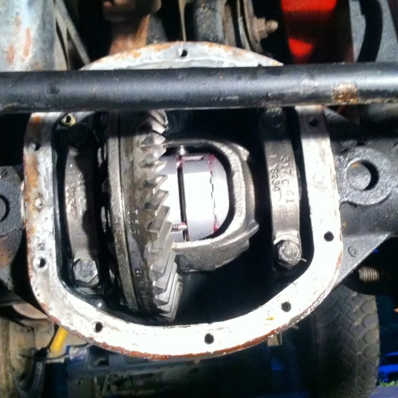

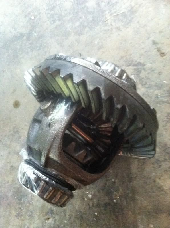

Ill try and run through the Aussie install, I took several pictures but once I got the carrier out things got pretty messy and I didnt take any.
Obvious first steps is to get the Jeep on stands, pull the front wheels, brakes, then hub assemblies and slide the axles out about 6 inches or so to let the carrier come forward out of the housing.
Then grab something to catch the fluid and remove all the diff cover bolts except the top one (leave it loose). Seperate the cover and let the fluid drain out, then pull the cover off and set it aside.
Once everything was opened up I took brake cleaner and cleaned the oil off to make things easier to work with. From this point forward is when being thorough is mandatory. The carrier needs to come out, and ring gear has to be removed from the carrier to get the center pin out. My pin would not clear the 3.55 ring gear. Everything in here must go back exactly as it was. Mark the bearing cap retainers in a way that you will know their original orientation. They must go back on the same side and bolted in with the same end facing up as it is here. Using a punch, I lightly tapped one mark into the top of the drivers side retainer, and 2 in the top of the pass side.
Now remove the 4 bolts holding the carrier, then remove the retainers and set all the aside. The carrier is now ready to come out, it took a little gentle prying but mine popped right out. Note: as you are doing this, keep an eye on the bearing caps if they fall. They need to go back on the same side as well. Now the housing should look like this.
Back to the carrier, I used plastic bags and a couple of my wifes hair ties (oopss) to seal up the bearings from dirt during the rest of the process. After this is where I quit snapping pics however. Also, it is important to look at your spider gears, give them a smirk, and tell them "**** you and good riddance"
The Aussie directions cover the install fairly well, although they are somewhat general for many applications. Ill just kind of mention things that were of importance.
Wrap a rag around the carrier and stick it in a bench vise. Using a permanent marker, mark the ring gear to carrier orientation so you can match it up again later. I marked 3 spots in case I wore the permanent market off one. This turned out to be a smart practice.
The bolts are torqued to 80 ft/lbs, something with nice leverage will help. Remove the ring gear, tap out the roll pin, the the center pin and rotate the spiders out, CAREFULLY watching the thrust washers! These must go back where they came from well. Aussie had good instructions for putting the locker together, just make sure you use feeler gauges to measure the two gaps they call for, making sure they are in spec. I used a lot of grease to keep everything together in the process.
After everything is in there, slide the center pin in and secure it with the roll pin, then match up the ring gear and torque in a star pattern. Then its just a matter of installing everything in the housing just as it came, clean off old RTV and use brake cleaner on everything one last time before applying new RTV and putting the cover back on.
I installed my IRO rod at this time also.

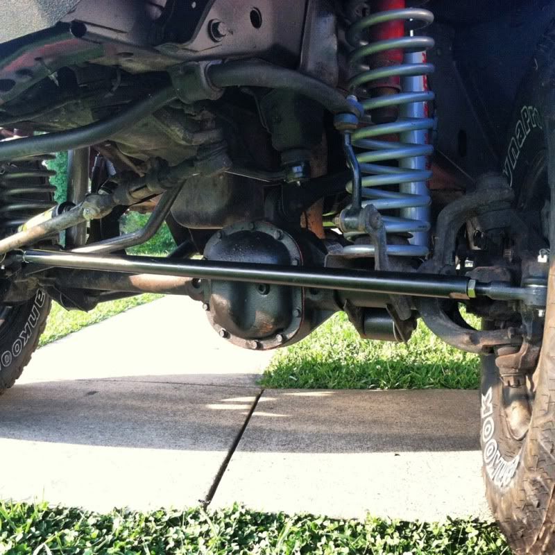

Jp man, I assume youre talking about a stock trackbar and endlinks. I dont have swaybar disco's cause I almost never rum swaybars. The last pic was a rarity because I had to haul creek rock that day.
As for the trackbar, its redrilled over and axle is perfectly center, and since I drive an hour to WBR, beat on it and drive it home, its comforting to know every parts store carries a trackbar if I bust one.
Hasnt hurt flex much or anything.
Yeah I was. Fair enough, don't blame you that line of thinking.
