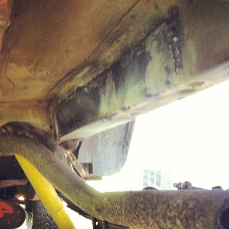

Work has been wide open, so as usual Im stuck in my pre-wheeling trip crunch time. Ill be back at WBR to wheel again in 3 days, and still a lot to do. Tonight though I did manage to get everything welded up on the rail, then put the tank back in and fired it up. First time its been started since last week.
Before grinding/paint. My out of position welding is booger worthy at times but its burned in solid, my mini-sledge performed that test lol.
Im going to start on the Aussie install tomorrow afternoon.

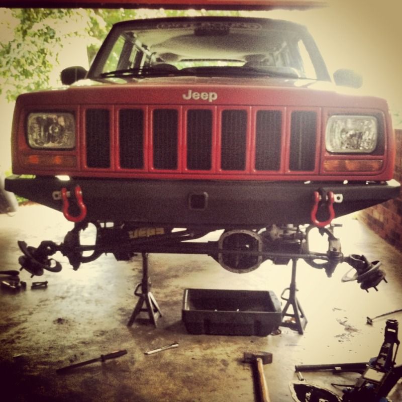

Originally Posted by VegasGT View Post
MTBlue and I had his Jeep in this condition yesterday. 2"bb
D3<!L!>3D
S8NNG8 is online now
post #510 of 2859 Old 06-20-2013, 08:41 PM Thread Starter
VegasGT
1988 MJ Comanche
Location: Leitchfield, KY
Posts: 5,395
Nice nice.

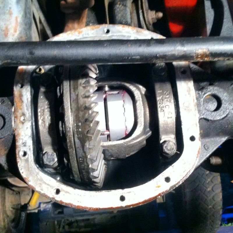

Well, as of this afternoon no more d30 spider gears for me.
I took a fair amount of pics throughout the process I will try and post up later on to serve as somewhat of a mini-writeup. The whole process was really simple tho, I just recommend taking extra care to mark everything and put it back exactly as it came out.
Ive gotta button the rest back up tomorrow, so Ill be able to truly test it then. Pumped.
