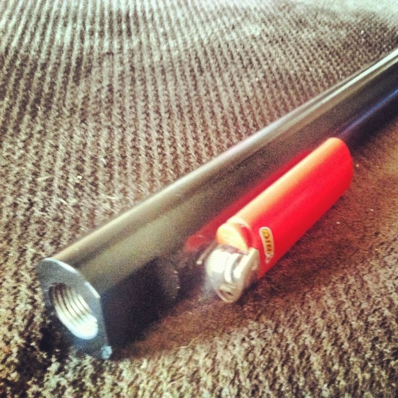

Iro tie rod?

^yep.

Mint
Mash it for me let me know what you think

It will be put to the test next weekend for sure!

Does it take the stock tres if so I'd grab a few for spares

Yea it does. Technically makes the TRE's the weak point but Id rather that be the "fuse" in the setup. I have spares and thats an easy trail fix. Much easier than trying to straighten a mangled factory rod lol

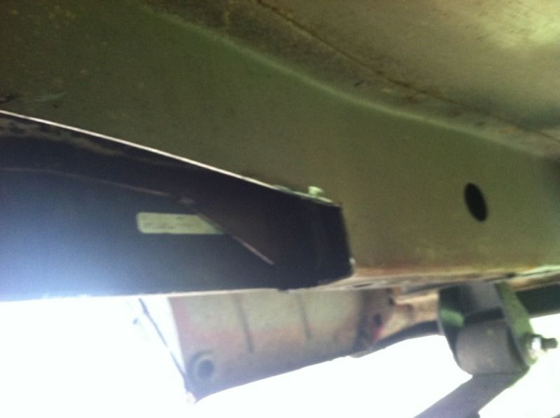

Well, today is the day I tackle something Ive been puttin off for a while, unibody rail repair. Im halfway done but am taking a beer break before I burn anything in.
For safetys sake, I pulled the tank. Went super smooth, and I manhandled it out with no problems. Note the shadetree mechanic status I got going on, doin it all on my back porch slab like a boss.
With no tank in the way, my view and peace of mind is much better, on the pass side rail near the bumpstop you can see my problem.
Inside the rail:
Outside (yikes):
Im still a little unsure how this spot got so much rust, the rest of the Jeep is very solid. My last '99 had rot in the same area, strange. Either way its gotta come out, so starting with the outside rail I cut out the rust on that side and grinded down to metal around it where the new 3/16" plate will be burned in. As u can see in the pic, I had original made incisions to cut a rectangle out but realized most of that metal is still good so I went with a trapezoid.
Thats where Im at for now. Ive precut the 3/16 plate to run about 15 inches down the rail, and contoured it to the slight bend. Plan is to burn it in on the outside, then weld it from the inside of the rail before I do the inside plate. Then after doing that I will cap it together with bottom plate and call it good.

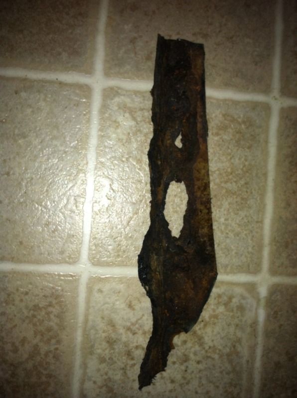

****ty Harbor Freight special run reverse polarity DC for the 6011 rods. Tinkered with a lot of settings til I found a sweet spot. My biggest problem I think is being able to maintain a good arc length and angle in awkward positions.
That and I really need a 220 connection out here, Im used to welding on a much bigger unit but I picked up my lil 110v job to do odd things around the house, its been great for a wide variety of things but it has been VERY inconsistent during this whole process. There was a couple instances where it would have a weak arc and stick the rod, then moments later it would pick up and practically blast through the rail. All with no settings touched. First time it has done that.
Going to try and build a garage in the next year and have me a nice hosscat of a welder for my duties then. For now though Im moving on with what Ive got. Went ahead and cut out the rotted inside edge of the rail, although it was about to come out on its own, heres one piece that stayed together.
Now that Ive got that opened up, I plan to also weld that outer plate from the inside of the rail before I cap everything off.
I also believe I will leave a hole in the bottom plating for drainage. Ive had 3 XJ's now that have had rust in this same spot, 2 of which were totally solid otherwise. No signs of rear end collision. I can only assume water getting trapped there plus exhaust heat has caused this over time. Once its buttoned up I plan to pump ATF in the rails from time to time to help prevent future issues with corrosion. I HATE RUST, and the unibody thing makes me fear it even more.
