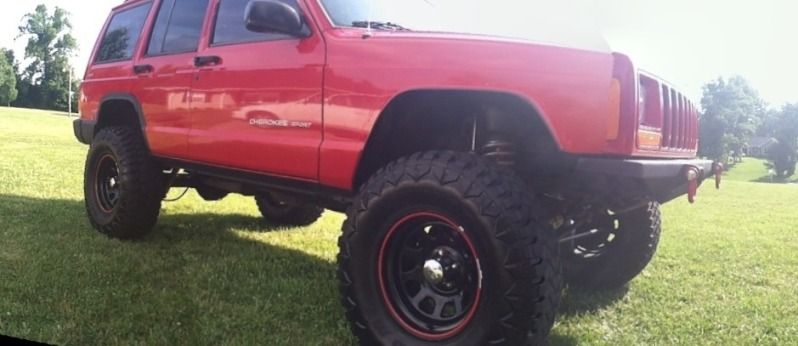

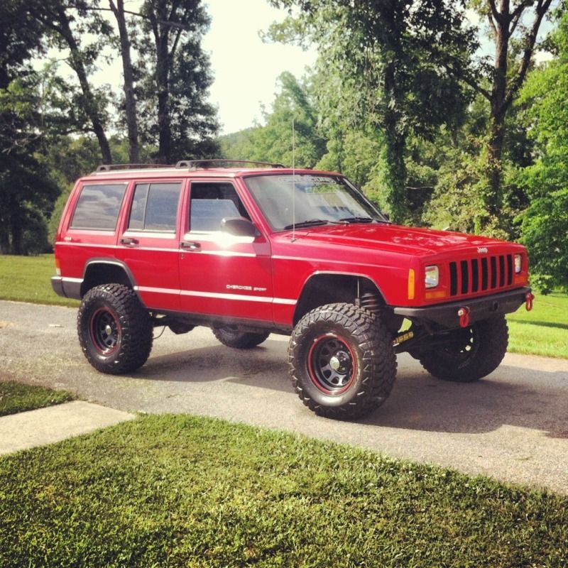

Next ride at WBR isnt til the weekend of the 22nd so I went ahead and washed it real good to pull mall crawler duty til then. Forgot how well it cleans up.

post #452 of 2859 Old 06-05-2013, 06:23 AM
DNFJ
Location: Pittsburgh
Posts: 4,396
wtf is up with your header panel
Lol I just noticed that. Bottom pic is taken with a ****ty panoramicc view app, guess it screwed up when it stitched pics together, header is fine.
