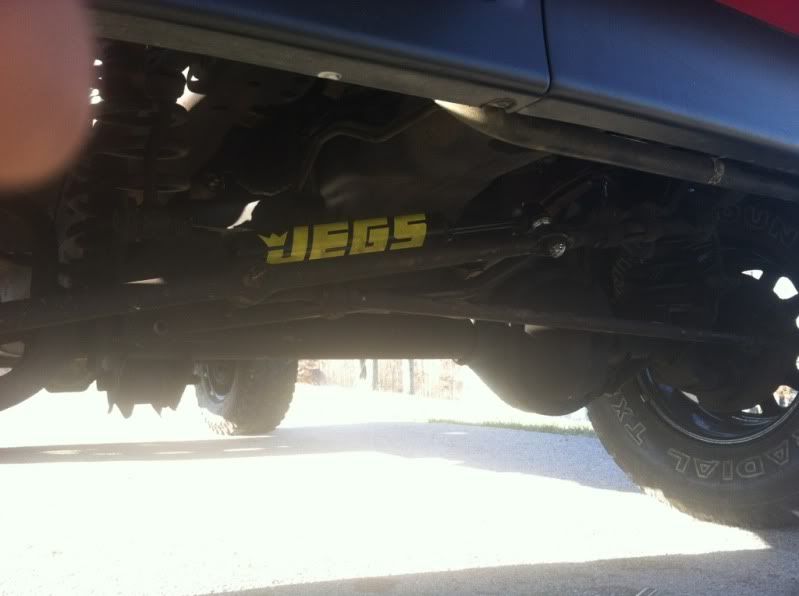

Fixed leaky tranny line and installed a new cheapi steering stabilizer just for the hell of it. No problems but the stabilizer was original and changing it wouldnt hurt. Slapped on a Jegs sticker for 50hp gain.
