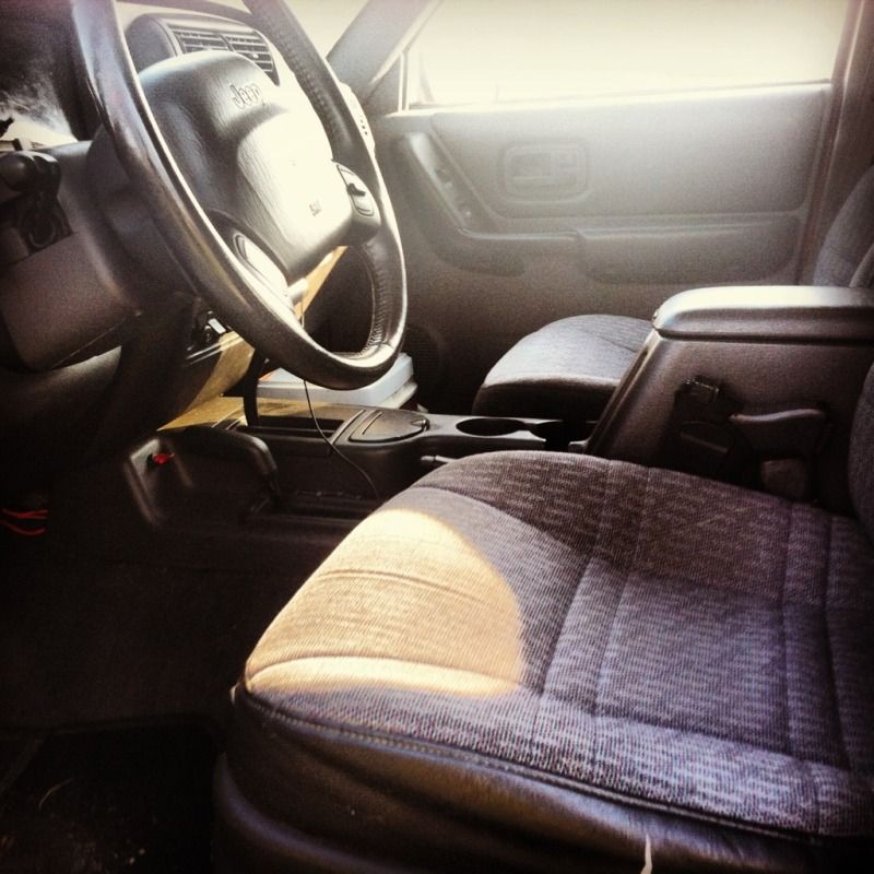

Also a quick interior shot. Im not trying for an apocalypse build or anything but a G22 at my side ready to rock would be a damn good start to one haha.
And a pic sitting in the driveway this evening.
