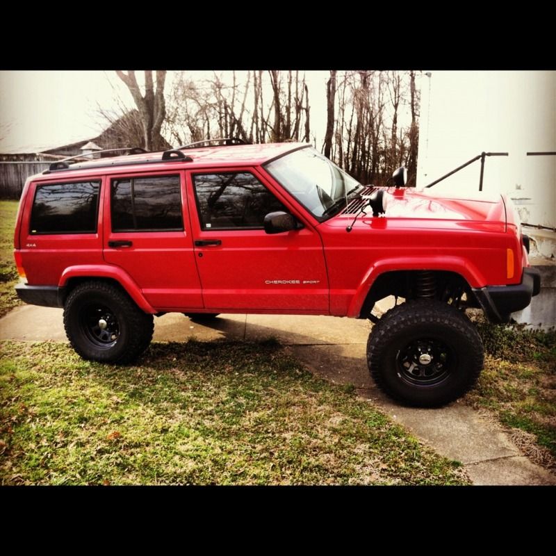

Yes sir. Nothing impressive, my front shocks are too short to droop out on out. The rear seems to be performing well considering the poor shackle angle.
Can you put in 12 shocks? Just wondering
Nice flecks for a mild jeep
