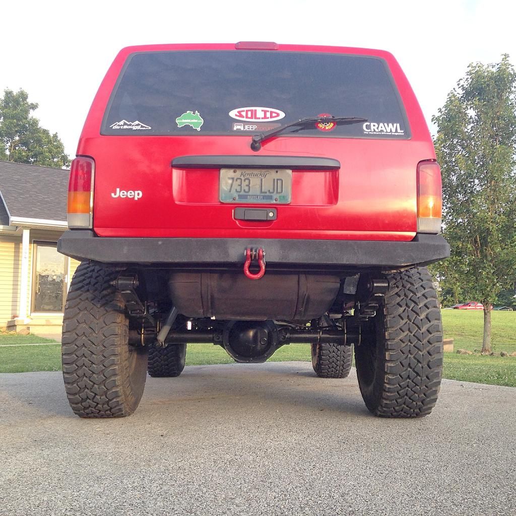

I actually got passenger side in and all set up. Just ran several tack welds on it because I was too lazy to fool with the old broken off bolts. Just gotta wait for my extended brake line then check the stops to see if I need to add a puck in there. Dont think I will but it depends on how much these compress.
You can see the shock shaft left and bumpstop to ubolt plate distance are very similar. Shocks are 10" travel.
Shot of the whole bump setup/raised shock mounts:
This ****s really starting to come together.

Got drivers side done and did some testing. Heres drivers side at ride height:
Then drivers side again at full bump:
Overall its working damn near perfect, except there does appear to be more uptravel to be had. Theres still some uptravel left in the shocks, and the tire had a little more room before contacting the fender. Ill leave it alone til I get more testing in, as this wasnt a real tough bind, just a quick flex on the creek bank. Its possible that a tight bind will droop the opposite side more, pivoting off the bump and actually use that last bit of uptravel I have. Even if not, Im not wasting much travel, worth it to have that safe zone.
Heres where I was at when I took the pic of the bump contacting on the passenger side. LOTS more droop in the rear on tap but I couldnt pull up the mossy rock ledge very easily.
Heres the passenger side at full bump. You can see the Omix-Ada replacement snubbers dont have much give to them.
Im pretty tickled with this overall. I cant honestly say I havent taken the time to do this with past XJ's, but I know the payoff will be worth the effort. Aside from that, I managed to get this end result in the name of thriftiness by fabbing the bumpstop plate contact points and shock mounts. Not to mention shopping around for the best price on the frame side snubbers. After the Omix-Ada bumps and material/consumable cost Ive got less than 40 bucks in my rear bumpstop/raised shock mount setup. Clifford the Big Red Tastefully Cheap Unibody.

Looks great! The rubber bumps will soften up and compress a bit more. I think you could've raised your shock mounts up a little more. Mine are at the center of the axle tube and they seem perfect

Thought about raising them more but where I put them seemed to be about right for me, especially if the bumps compress a bit more over time.
Actually could be the angle of my last few pics. Shock mounts are up there pretty high over factory.

Damn that came out really well. Though I feel like you could have had slightly short bumps to gain some more uptravel, it will like you said, compress over time and you'll gain a little bit.

X3 on the tank skid. It's basically an open target with your folded rear quarters and all that up travel

Thanks guys! Ill be keeping an eye on the bump setup out back when I get the chance to do some real testing. If needed I can always trim the rubber down a bit on the frame side bump to get that last bit of uptravel out of the shocks.
Haha I know it, tanks just hanging out back there with all the other beefed up, high clearance **** like "oh damn oh damn oh damn watch that rock."
Its on my to do list soon, actually been talking to the shop foreman at Dirtbound Offroad about potentially offering a DIY tank skid kit. I feel theres a good market for that, a lot of people out there like myself that dont want to pay full price for a skid, but dont really wanna full with all the measuring and drilling of building one.
As is though I just adapt my driving style a bit to cater to the tank being unprotected. Careful line choice goes a long way, if Im coming down off a big ledge, i usually cut the wheel last minute and ease down it at an angle so if anything hits its usually the leaf itself.
