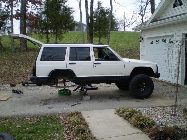

Thanks man! Im just warming up with this one, although the rest of the plans will be a bit more tedious. Im a father/husband as well so I keep things pretty budget minded myself, but luckily my intentions with the build dont necessarily require a huge budget. Im just trying to tailor the Jeep to my needs, not so much the "bigger is better" trend. I one day hope to be able to call it an expedition rig of sorts, but I have lots more to do before that.
As for that white XJ ('96 btw), it was my first and Im almost ashamed to say how it was lifted haha. I built 3.25" spacers out of 2.25" ID steel pipe, welded to a big washer to seat the spring. Rear was 2" blocks for a couple weeks til I got my donor s10 leafs to build a bastard pack. Ran stock shocks, spaced up with a ton of nuts and long bolts. It was ghetto-fabulous but I had the time of my life with it. Wheeled the crap out of it, blew out d30 spider gears and busted the 27spl 8.25 after 33s and a lotta throttle. Nothing special about it but I miss it sometimes.
For fun, same Jeep flexin on 235's. Next pic is after 33s, tore down mid swap (put in 29 spline).
Kinda hi-jacking my own thread here but that Jeep never got a build thread due to all the ghetto hackjob it started with lol
