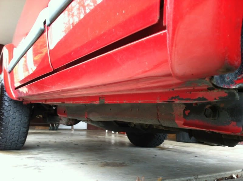

Not new to XJ's by any means, Ive had several and I had no intent on making a build thread for my latest. I have no extreme plans, as the Jeep is my primary DD. Things never go as planned though, and my original plans of Rubi wheels and no lift were quickly tossed out. However the new XJ is pretty clean (dent and mostly scratch/rust free), so the build will be based around the ideaology of a mild yet capable rig thats easy on the eyes without going all out on spending.
Jeep is a solid '99 XJ, 4.0/AW4 with hp30 and 8.25. Bought it off an old man that took good care of it and stayed up on maintenance for the most part. Has lots of new gaskets and everything is in nice shape in and out.
Heres a few pics to get started from the day I got it.
More to come!
