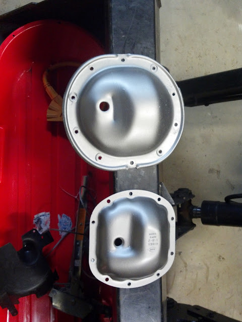

Got the jeep back today. Drives MUCH better. More power than before the lift now. I may try and go up to 35s if I can get enough for my tires and get some cheap enough.
I badly need my speedo corrected though. When it says I'm doing 75 I'm really doing 55. I'm happy though cause I can figure the rest out from there. I should find my GPS though so I can keep a better eye on it...
The Drag link rubs hits pretty bad on the lower sway bar bracket on the passenger side. Fine for now on the road but definitely needs addressed soon. I may try modifying it myself though and just redoing my alignment since it was easy enough.
ere is a picture of the new front locker carrier and 456s
And the new rear 456s
I would go back out and take some pics of the diff covers on the heep but it's 14* outside and windy. so **** that. Here's the color they are though.
Watching them dry:
Done and waiting to be put on:
The dude got me some nice new chrome bolts for the covers and they look really kickass with the stainless paint. Pics of everything else tomorrow maybe. depends how I'm feeling
