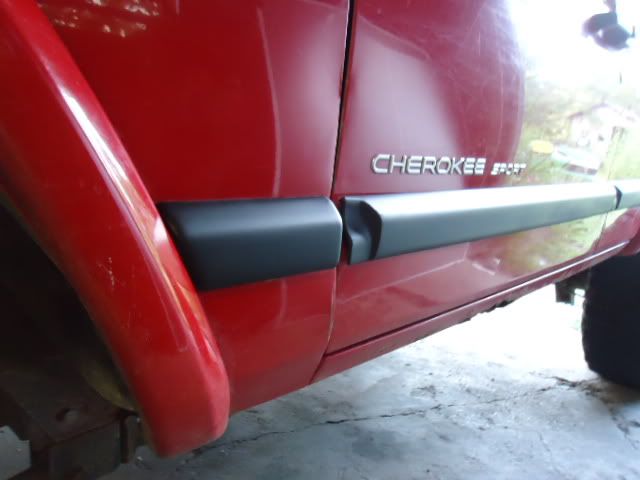

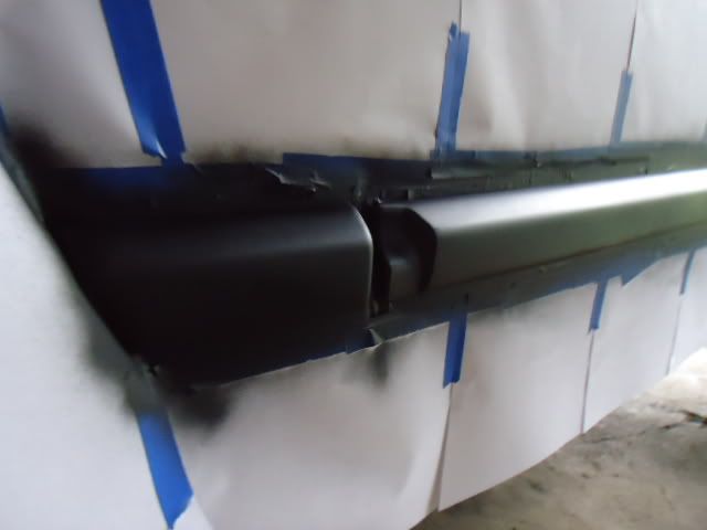

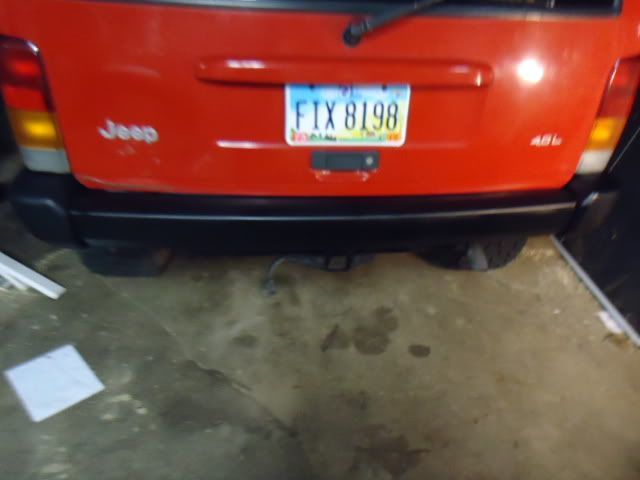

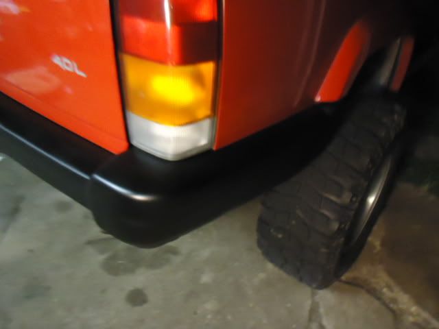

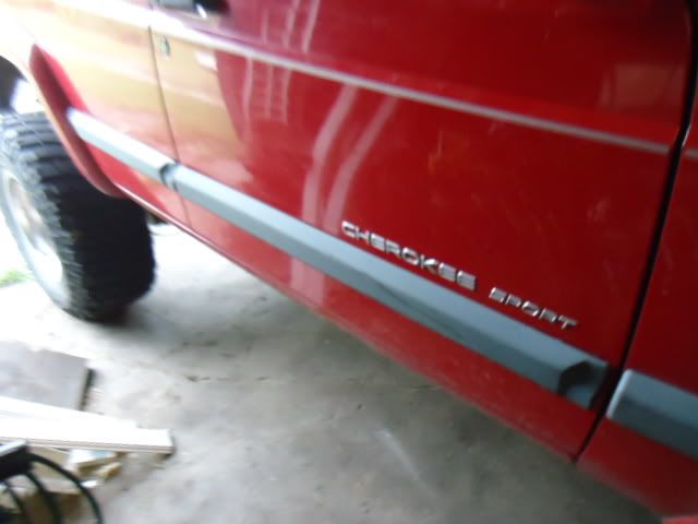

I have plenty of evening time on my hands but no money to do anything big so I decided to do a little cosmetic touch up the other night. The trim was faded to light gray so I got me a few cans of rustoleum flat black and decided to go to town. My front bumper is a custom winch bumper and it is black, the factory rear bumper was red so I decided to paint it black too, to match all around. I used some interior masking tape cause it is what I had and fax paper to do the masking, it worked just fine. I'll tell you what, for about 10 bucks worth of paint this really made a big difference. It made it look so much cleaner and straighter, you ought to do it too if your trim is fading my skill level with paint is about a -4 so if I could do it just about anyone can.

I just sanded the old paint lightly with 220 grit sandpaper. I heard someone say one time that as long as you arent doing body work that is the best way because everything under the factory paint has already been prepared and will stay on good under the new paint as long as it is scuffed up real good.
