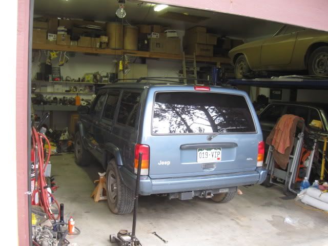

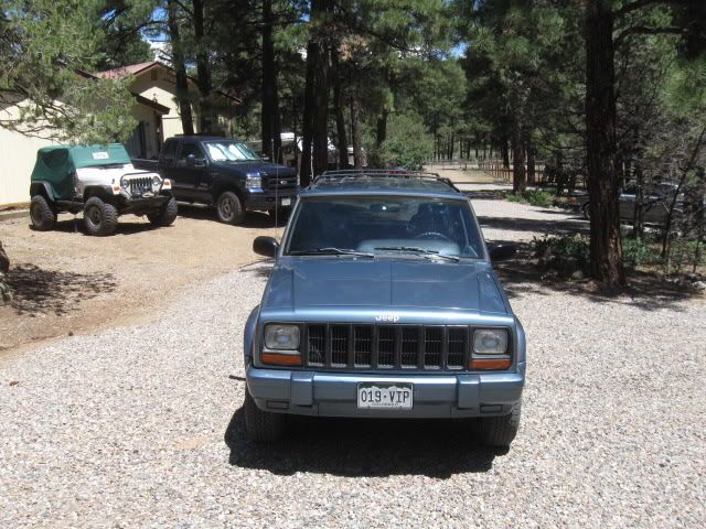

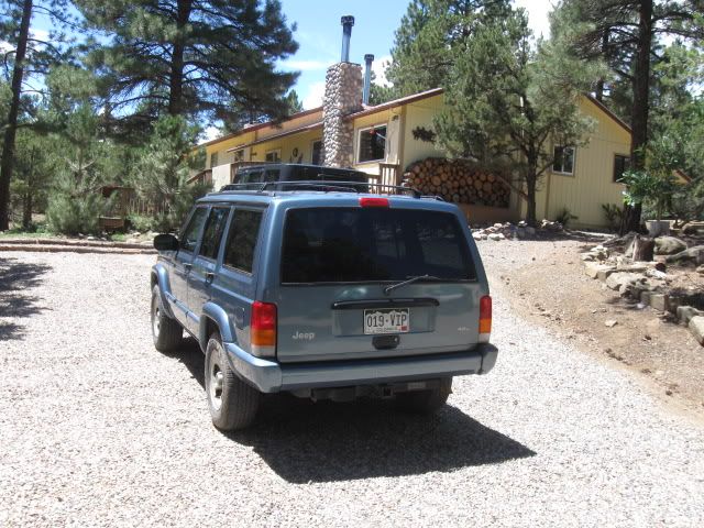

A TJ guy tries his hand at building an XJ (updated with stage 2)
EDIT: Resurrecting this old thread for stage II instead of starting a new one.
Never did a build thread on the TJ and have regretted it so here goes.
After wheeling with a couple of guys who drive XJs (pyrotyro from the forum for one) and trying to deal with driving an F-250 as my main winter driver last year I decided to look for an XJ. Up here XJs for sale are rare as a Hummer that wheels but I did manage to find a '98 Sport with lots of options and only 103K on the clock, started life in Las Vegas with some time in So Cal so it's totally rust free. NOT my first choice of color but beggars can't be choosers.
Stage one was doing a "zero mile" maintenance, serpentine belt, all fluids including power steering, (brake fluid flush will be done after installing the YJ hoses), and check every wear item. The truck came with a bunch of maintenance receipts and looked like it had been well maintained.
My goal is a rig that can handle trails up to and including Poison Spider/Moab Rim, load up for expedition wheeling and do DD duty in comfort. My TJ will do the tough stuff.
Looks just like an XJ only smaller
The UPS guy is pretty tired of stopping by our house. I sold my '51 pickup project to fund part of the upgrades.

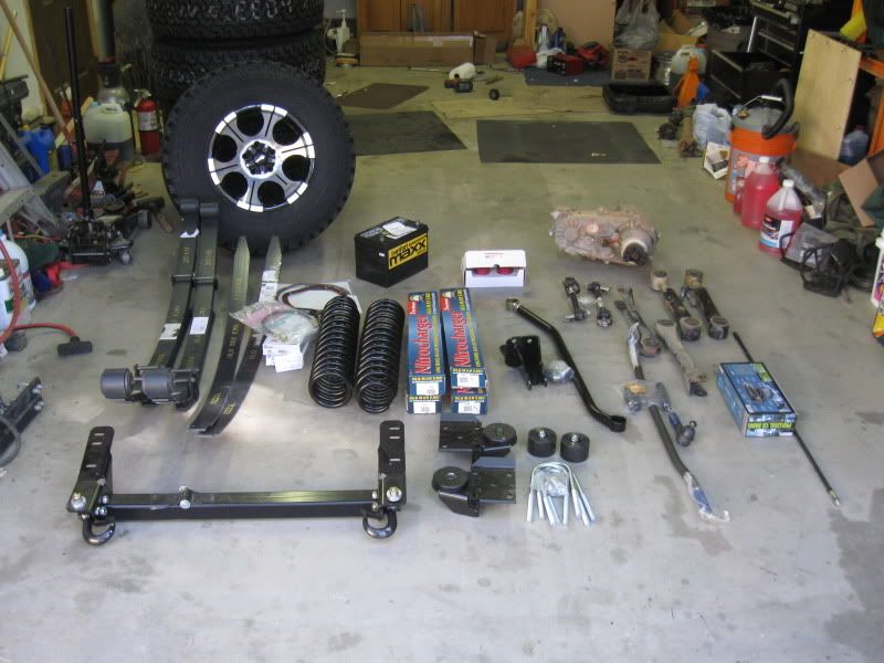

The stage 1 build list consists of:
5 31"x10.5 BFG ATs on D1ck Cepek DC2s, not my first choice of wheel but cheap and coated so they will resist the mag-chloride that gets laid down on the streets.
RE/Currie F&R bumpstops
IRO track bar
IRO front hook system which will become an attachment point for a tow bar so I can flat tow it behind the camper.
ZJ tie rod
RE U-Bolts
YJ Brake lines F&R
Alloy USA D-30 axle seals
JKS quicker discos and lower control arms (left over from a TJ stage)
Stock front upper control arms with only 30k miles on them in case the bushings are bad in the XJs.
Uniden 520 Pro XL CB
Low mile (40k) TC with SYE in case I get vibes (from TJ replaced with Atlas II)
OME medium rear springs with D22XL add a leafs.
D-30/8.25 Lube lockers
Currie front springs (TJ 4"/XJ 3")
OME long travel 35/36L shocks
Walmart 770CCA battery.
Not in pic but on the way or on the shelf
Ruffstuff diff covers
Low mileage front shafts from the TJ (30k mi)

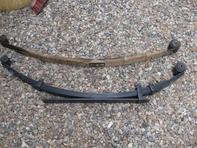

New vs old, didn't put the add a leafs in, won't unless I need them or the springs sag too much.
Forgot what fun leaf springs are, haven't dealt with them since putting a 2.5" Rancho lift under my '56 back in the mid '70s. A couple of hours I'm almost half way through one side of the rear. So far the Kroil is doing its job, and once again I am very happy to have a full set of air tools.

Is that a 74 nova on the lift? J/W.

Looks like a Volvo P1800 to me? What is under the lift (black one)??

We have a winner! Top one is a 99% rust free '67 Volvo 1800s with a later B-20 engine, the one on the bottom is an '88 Volvo 240, one of the few vehicles ever made that will give an XJ a run for it's money for longevity. It's still ticking along at almost 220k with nothing done to it but oil/trans fluid changes a few sets of brakes and a lot of handling upgrades. Heck it even has the original U-Joints. BTW it shares the tranny manufacturer with the XJ, both are made by Asian-Warner, the 240 uses an AW-70 which is known for going 250K+ with a few fluid changes.

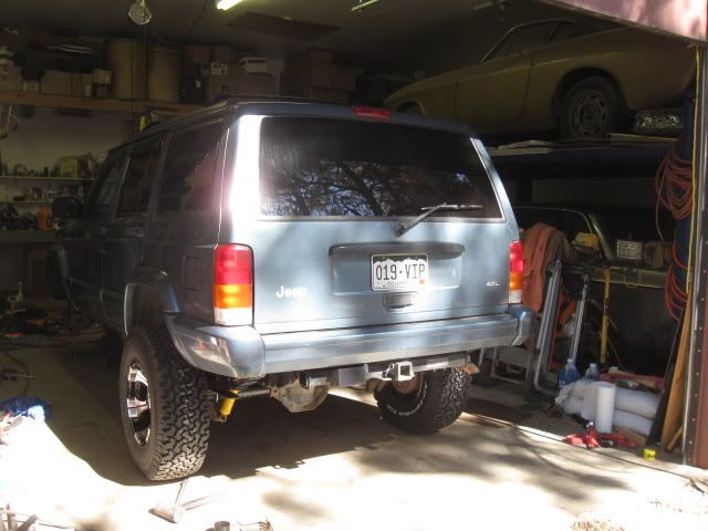

Looks good Dave! No fair...your rear leafs bolts all came out.

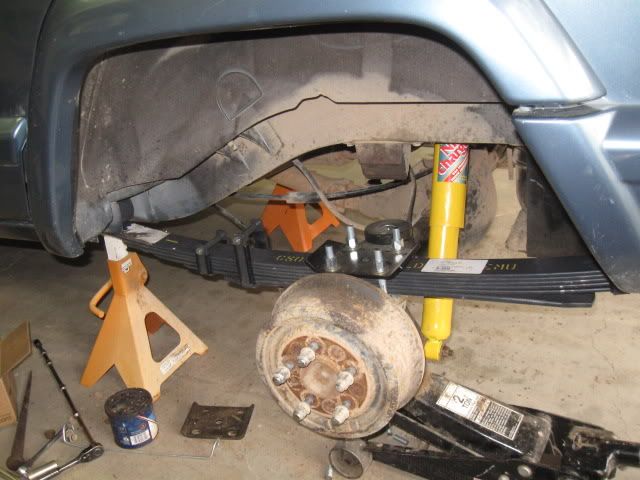

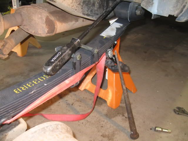

Didn't get a whole lot done today, had several commitments.
Ratchet straps, a marlin spike and pry bar work wonders for aligning the springs so you can get a bolt in. This finished up the rear end except for the YJ brake line, I left the flare fittings soaking in Kroil.
Anti seize ensures things will come apart again when necessary.

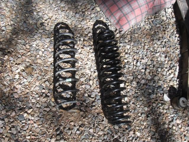

Before and after
Currie on the right, stock on the left (as if you couldn't tell)

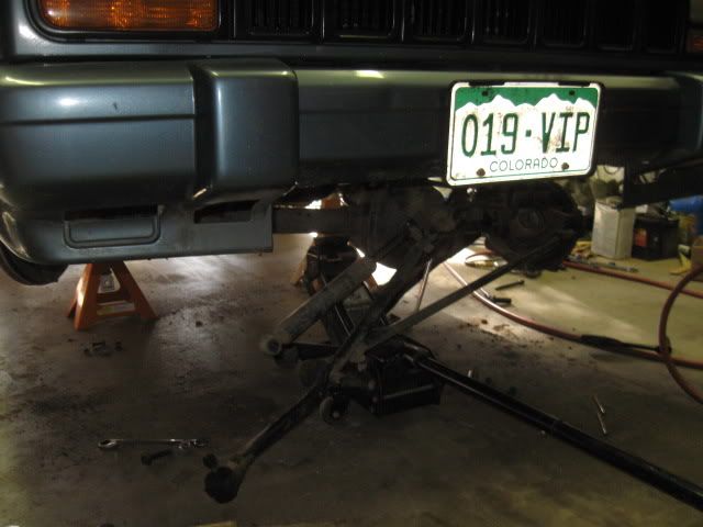

I got as far as taking the front end completely apart and had to stop for the day. Tomorrow afternoon springs, control arms etc should go in.
I really hope this settles a bit, right now my shackle angle is very poor and I'm sitting at a little over 4" in back. At this rate I'm looking at swapping TCs and a new driveshaft.
