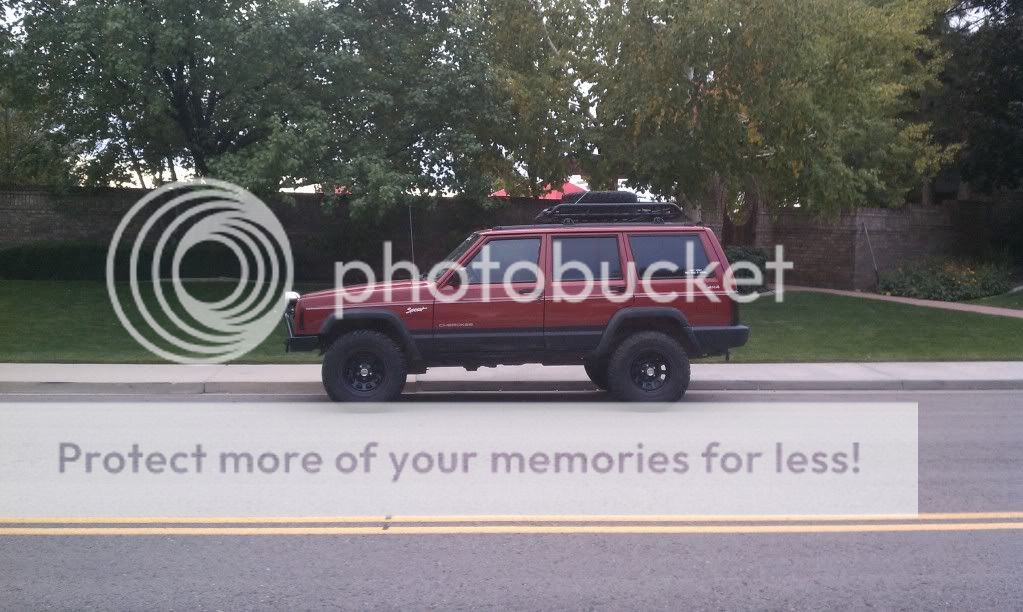

I promise you, you will love the shocks. My red XJ, lifted 5.5" and on 33's, rode better than stock with those shocks and RE springs!
