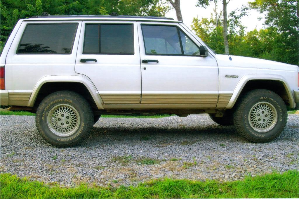

I love my bilsteins on the WJ. Jeff9 I have the HD leafs from quadratec and got 2" of lift from them over stock. Paired with a 1 3/4" spacer my XJ looked good and I also ran the JK shocks with that combo. I later added the main leaf from the old pack in with the HD leafs and swapped the spacers out for a set of rusty's 3" coils and still run the JK shocks. I sit right at 3.25" in the rear and 3" up front. this is with the HD leafs and 1 3/4" spacers.
  1. '95 XJ country edition, 4" coils/3/4" spacers, HD leafs with extra main added in, Ironman adjustable control arms, rough country shackles, aussie locker, JK rubicon shocks, 35" mudder's, soft 8's, cobra cb
