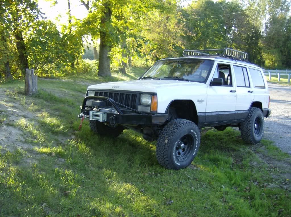

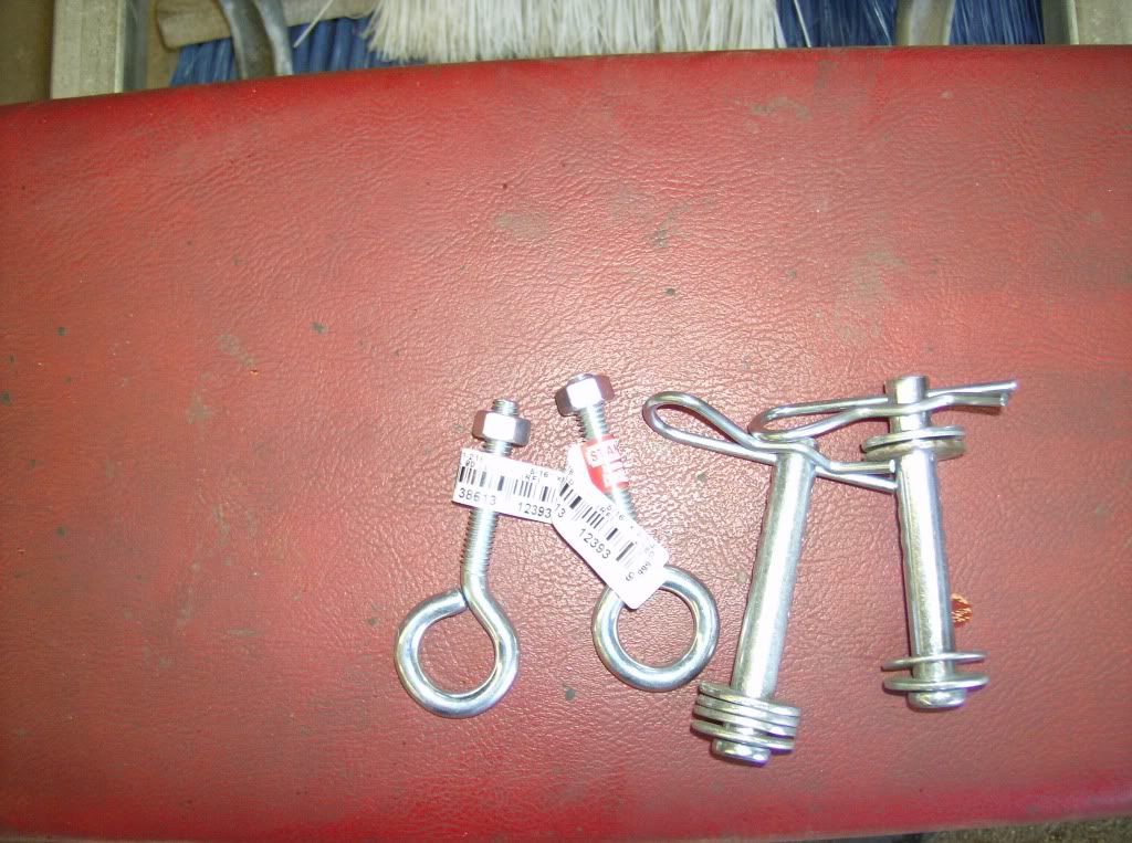

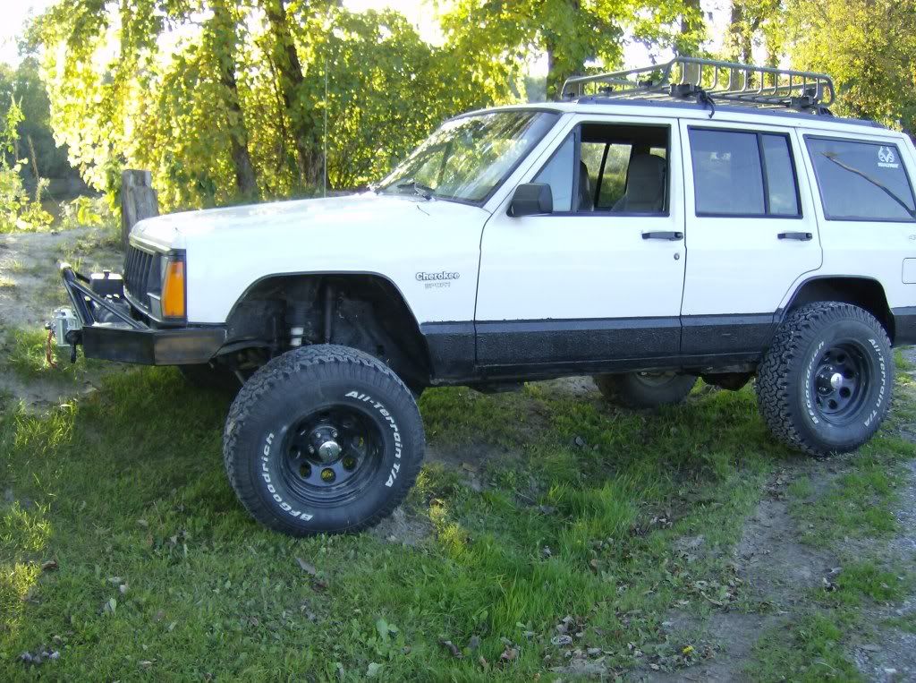

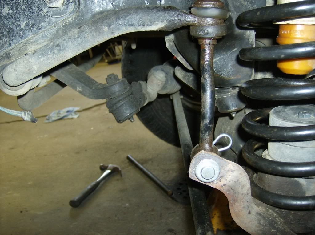

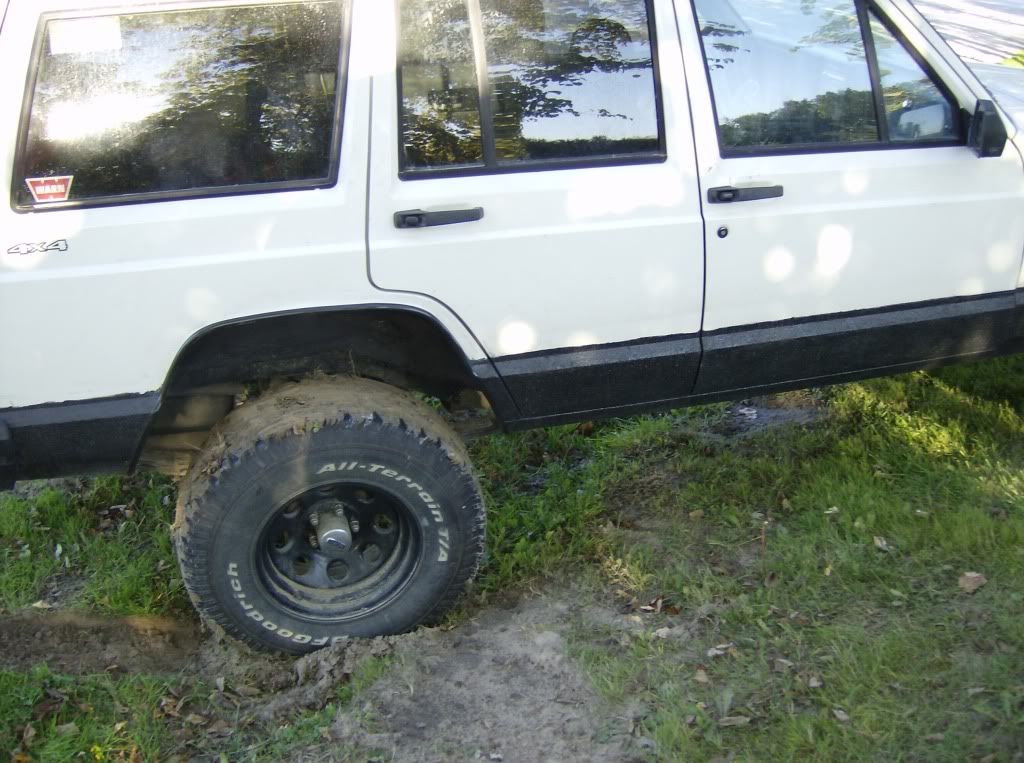

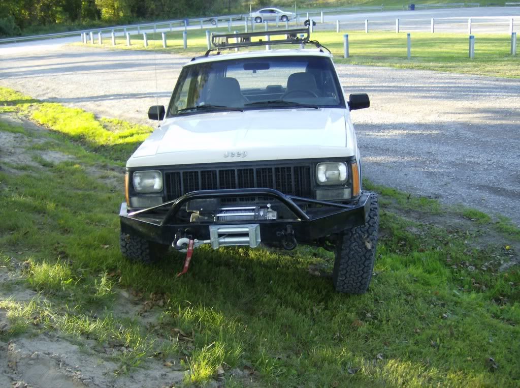

Alright guys i am updating this thread. i did my swaybar quick disconnects. i need to install my upper link brackets. the ride didnt really change much however it gave a smoother ride. it diff helped out flexing the suspension. but here is pics
