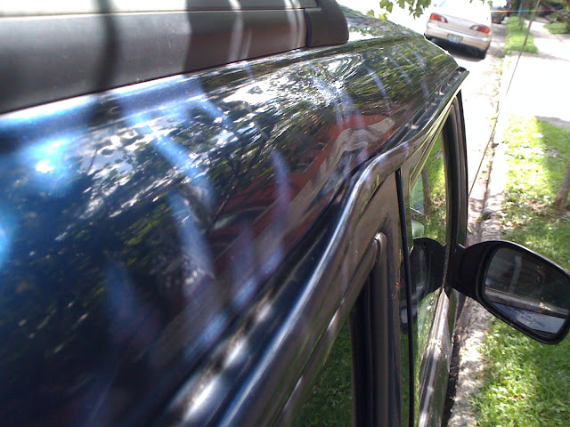

hoookay, so I want a roof rack, and I was looking at surco, because its cheaper than a lot of em. So I was going to get this rack (60"): Surco S4560 - Surco Safari Basket Racks - Overview - SummitRacing.com with these adapters: Surco GM100 - Surco Safari Basket Rack Installation Accessories - Overview - SummitRacing.com
only problem is a tree decided to dent my gutter, and I feel it might be right where the gutter mount would go. If anyone has this rack could you let me know if this dent would be a problem
If it would interfere, I could get the 50" rack: Surco S4550 - Surco Safari Basket Racks - Application - SummitRacing.com
or the stock rack mounts, or I guess the shorter rack and the stock mounts would work. I am not sure as the 01 has short rails that end at the b pillar.
SO anyone with pictures of either rack installed would be great so I will know if it works.

why not pull the gutter back out mate??
seems to me that it would be a better fix than trying to adapt to a bent gutter rail...

Tried and failed. Do you know how strong a rolled piece of sheetmetal is?? Pretty damn ridged if you ask me. Thats why it is only as dented as it is.
I tried prying it back out. Ended up just rocking the whole jeep on the suspension a lot. Maybe on jack stands, but It doesn't wan't to move as far as I can tell. The fender damage on the other hand pulled right out.

its easy enough. why not swing by alocal body shop and ask them the easy way of doing it?
hint, start at one end and work your way across....

My surco clamped right at where your gutter is squished.
I believe the mount bars are adjustable, so you could just move the front bar forward a bit.

You need a 2x4, a portable saw, a floor jack and a parking garage!
Cut the 2x4 to fit between the concrete ceiling or a steel beam and the gutter lip, jack up the XJ some and your gutter will unfold.

Interesting idea. May have to find a fixed steel beam sometime the right height. I dont think there is a solid place in my dads garage to do that. The I beam is to close to the wall, maybe the garage door fame/jamb (w/e it is called) would work... lol, i would only need a 12" piece of wood.. I have a feeling that going into a parking garage and start cutting 2x4's and jacking up my jeep, that people wouldn't like that.
