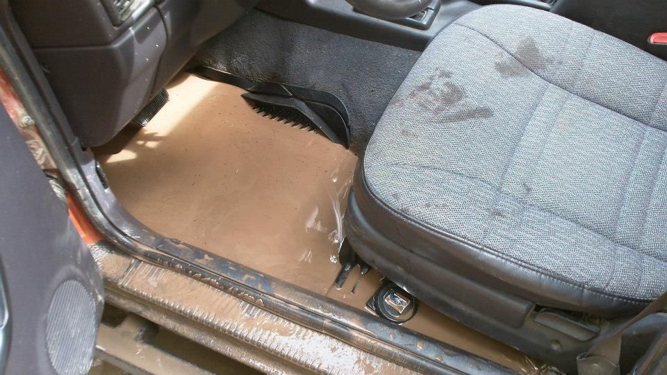

I'm a little reluctant to post the pictures because I don't think they're as bad as you guys may think.. But here goes...
How high it was in relation to the airbox.
Blurry, but you get the point. I think I may need a new speaker...
Rear floor.
The lines I was dealing with. I probably took the worst one...
The hole I could've been in. About 6 inches deeper. Probably from me spinning the wheel.
And I took this the day before.
I hope this satisfies everyone. Sorry if it wasn't as bad as you thought. But I'm still worried about it.
The doors keep trying to lock/unlock, my passenger mirror keeps moving on it's own. I might look into getting a replacement door rather than try to fix the electrical problems in this one.

If you haven't already, you need to get that battery disconnected. And yeah from what I see in the pics it's bad enough.

Those things that are "working" on their own are shorting out. You don't need the extra work of having to replace mirrors and lock actuators if you do fix it. It's highly unlikely but I've even seen flood vehicles catch fire from interior parts like pwr seat motors and such shorting out due to water damage.

First thing I did was disconnect the battery.
And I plan on taking the door panel off and taking a look, as well at at the OBD2 connector considering that was also under water.
I'll post more photos of the progress as it happens.

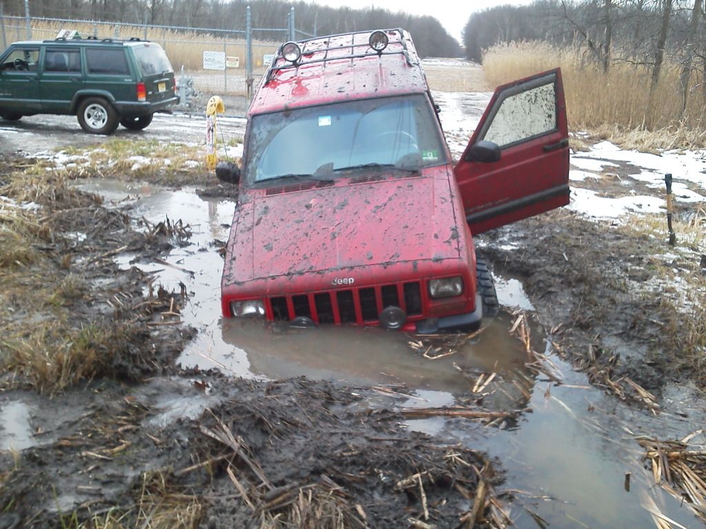

Been there before! This is after I opened the door, water was another 2" higher on the transmission tunnel. Spokes yanked me out and I said goodbye to carpet the next day
That red Xj is sexy!

Originally Posted by Spokes View Post
Change a fluids couples times. Rip carpet out. dielectric grease any connector u can. You'll be fine.
Think most of us have been here before lol I no I have. I've been worse but wasn't to concerned with pics at that point lol
Can't forget the sexy green Jeep in this picture
