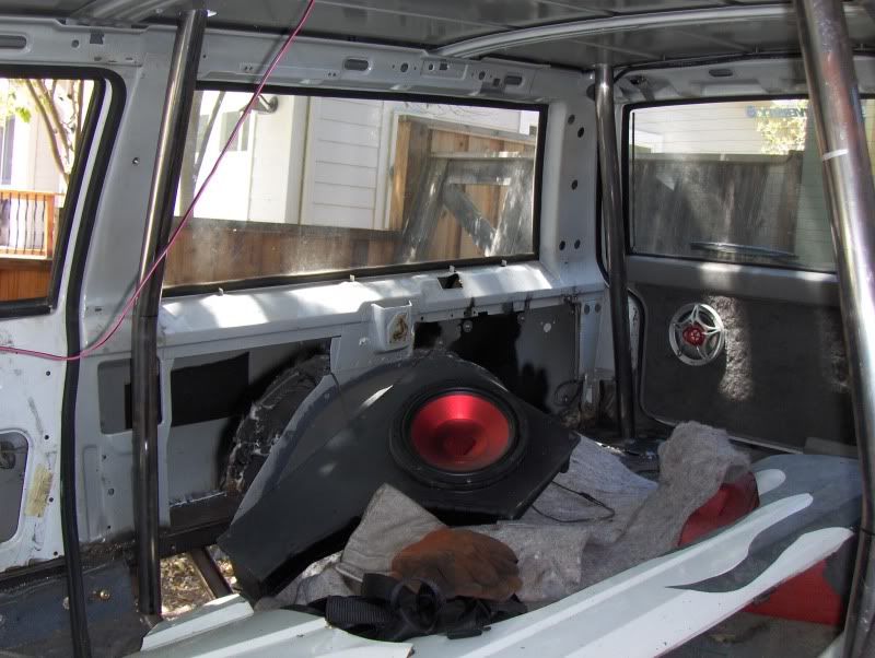

These pics were taken while I was doing my boatsides, so nothing is really complete and its in a general state of disorder.
Its a trailer queen, so Im not sure how it is on the street, but on the trail you certainly dont notice any more noise. Ill pretend like I lost significant amounts of weight my stripping the interior, but I doubt it would add up to much, especially with how much I added back in.
If you have an automatic tranny, you will notice a significant amount of heat increase if you take the front carpet out. It was almost unbearable wheeling in the summer, and I ended up putting a front stock carpet back in. Lowered my interior temps by a good 10-20*. IMO I would make the front carpet easily removable, but keep it. Ditch the rest.
