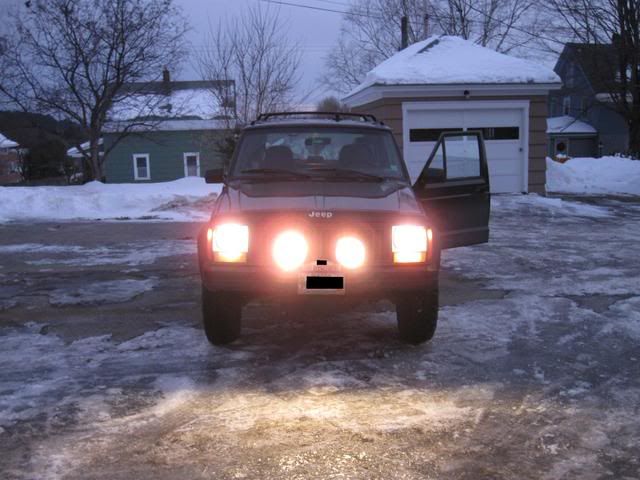

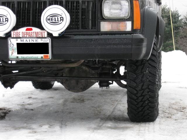

Originally Posted by norsky View Post
Thanks for the info. I need somewhere to mount my Hellas that are on the way and not sure if I want to go straight into the bumper or not.
I can help you out with the "not sure if you want to mount to the bumper"
Here's my Hella 700ff's. The stock bumper has 2 holes that are pre-drilled but one of them is almost impossible to get to without removing the bumper. So I drilled 2 new holes closer together. The bumper has a flat top, then it angles and then goes straight down, I drilled the holes right before it angled and that gave me just enough room to mount them and adjust them correctly.
Those are the best pics I have right now of the lights. Hope it helps you out
-Max Black 1996 XJ
Nice..looks good.
But I didnt think the holes were impossible to get to..theyre not the easiest thing in the world since you gotta have a nut underneath but it wasnt really that hard..
