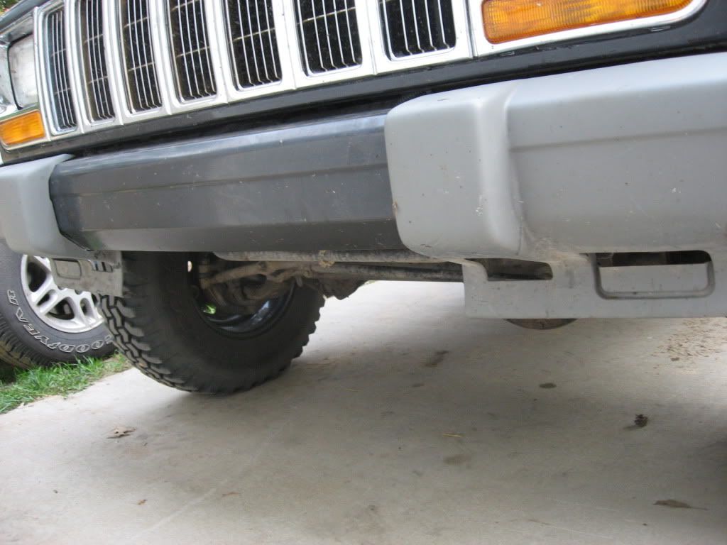

no there were 3 pushdarts holding it to the bumper, then 1 on each endcap holding it to them. Heres a pic..

Posts: 1,837
How'd you get them out then?

took a small flat bladed screwdriver and pryed them out, after they got a little ways out i grabbed onto them with some needle nose pliers and ripped them out the rest of the way.
