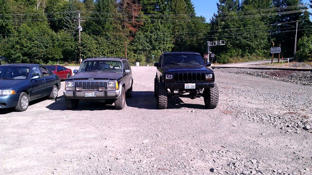

Let me start by saying that I bought my first XJ in 2005, been a paying member ever since (looking back i should have just bought a lifetime membership for 100$ back then). Anyways I have owned 3 XJ's, a ZJ, and also a WJ. Its taken while but I have finally got into a position financially that I can start modding. I'll keep this short for the time being since I have to head to work but I wanted to give you guys a look at what I have done and whats to come.
For years I have reading and researching and drooling over all your guys modified rigs, so here is mine.
Stock but still having fun

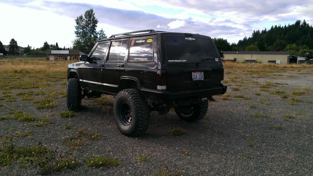

I'll update this more later today/tonight but I wanted to show it off. I have a long ways to go and lots planned but you get the idea.
As of right now i'm building a roof rack, Napier flares on order, and trying to figure out what route i'm taking with my rusted out rockers.

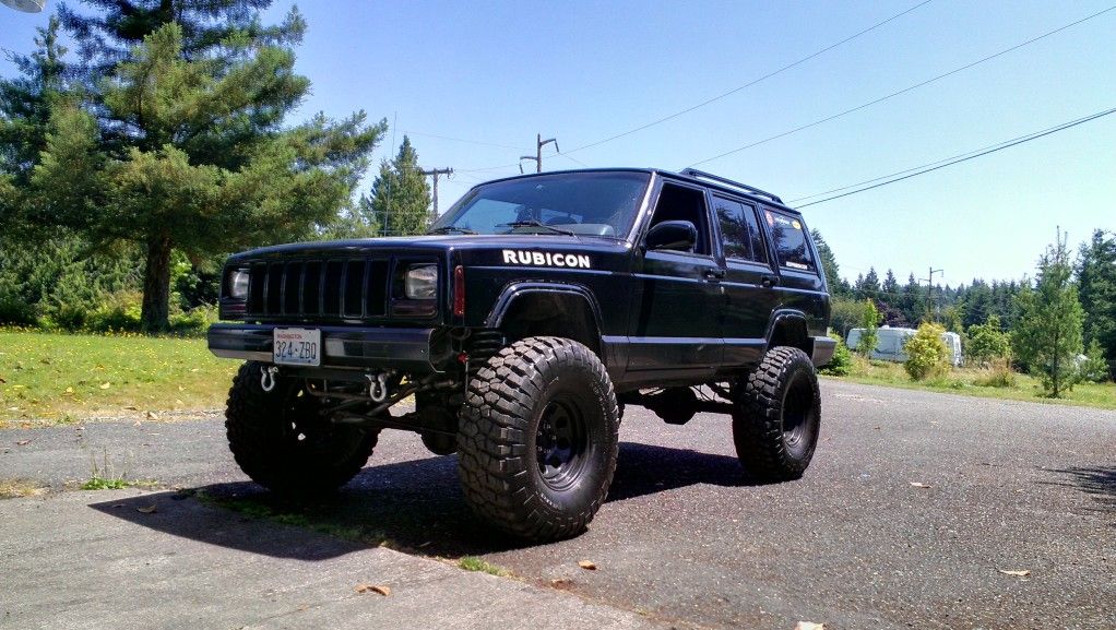

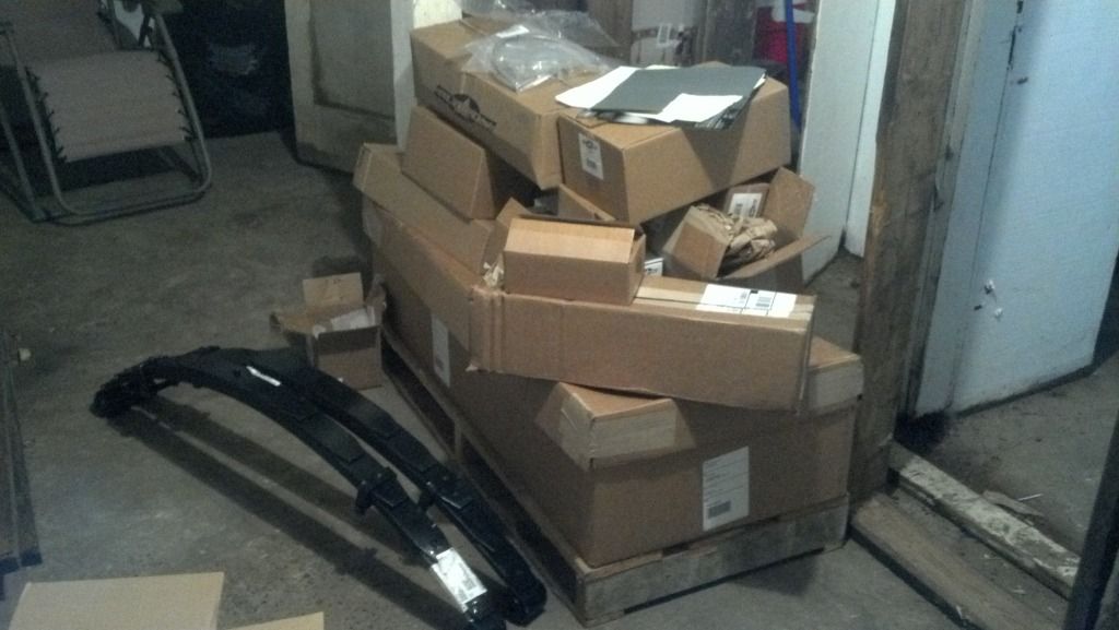

Thanks a lot guys. To answer some questions, as for the lift I have the Rubicon Express 5.5 with Drop Brackets (6200 Kit). I'm not sure as to what it actually got me as I didn't measure from the hub to the flare before starting the lift. If anyone is running around with the measurements from hub to a FLARELESS fender I could find out, but most say it gets you about 7 inches. That would make since as I am 11" taller when measured at the bumpers, so you figure 7 inches of suspension lift and going from a 28 Diameter tire to a 35 would give me another 3-3.5 inch lift from the added tire.
As for cutting out all the rockers and welding in square tube, well that was my original plan. Then I started reading more about how guys say you need to reinforce with some sort of brace to the frame and it all started getting a little complicated and ugly. I have heard that if you don't reinforce it you can actually bend the tube enough to keep the door from opening, and I dont want that. Right now I'm torn between going that route, or just removing the rockers, and replacing them with stock replacements and then doing a rocker skid below that.

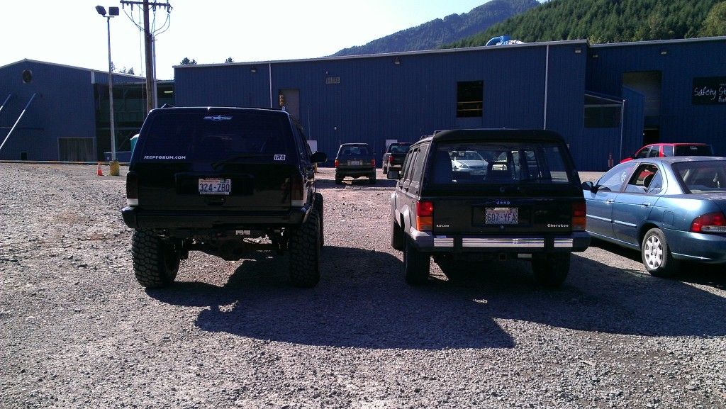

As that is my stock jeep next to his, I'm not sure how thrilled I am about this thread or post. I think he is picking on my jeep

Nah, but it would look a lot better with a budget boost and some 30 or 31's
