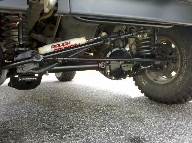

I have Solid covers front and rear. My tie rod does contact my front cover when I'm flexing and turning. The tie rod is built from 1.5 DOM tubing.
