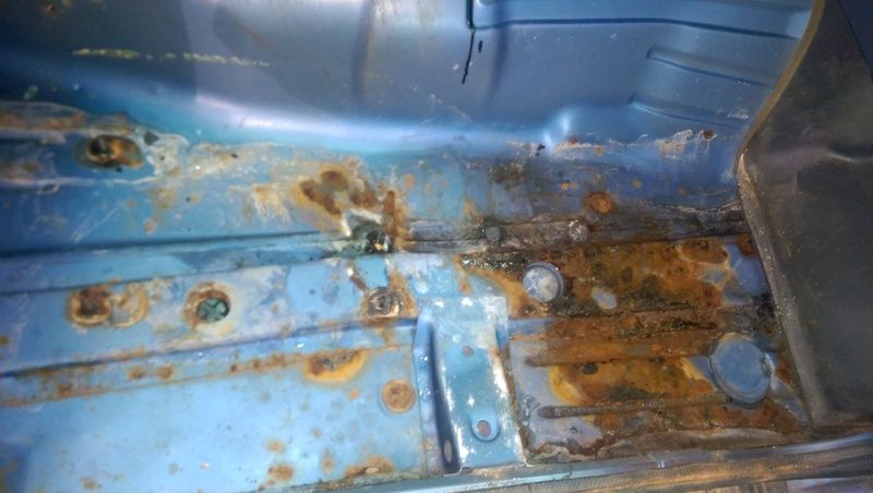

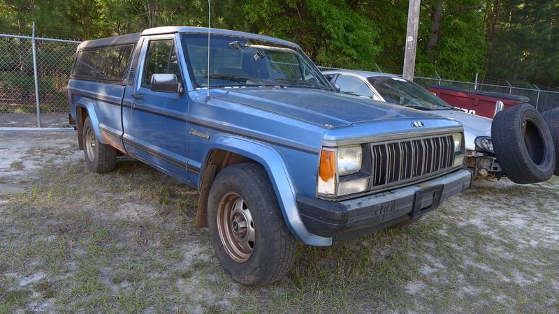

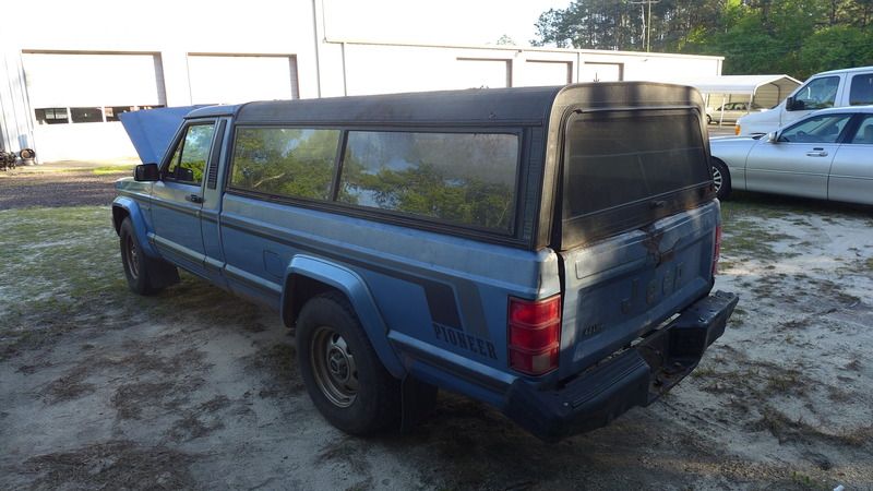

I've wanted a Comanche for a long time and I've finally got one. A mostly rust free, 4.0L, RWD, automatic longbed. For $350 at that!
She runs, but supposedly has a cracked block.

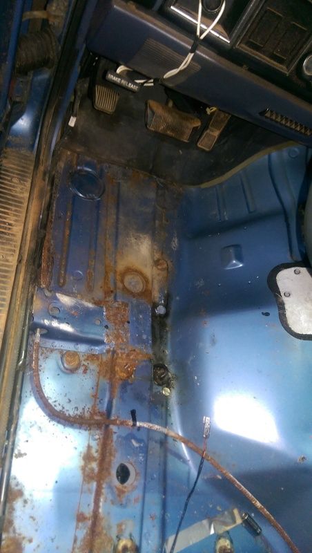

Completely rust free save for the floor pans. Typical Comanche rust, very treatable.

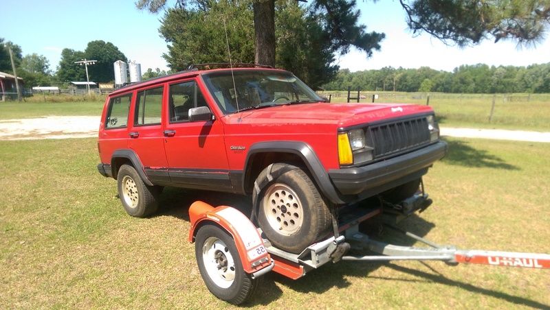

And, to kick things up a notch - an organ donor.
It's a 92 Jeep Cherokee Sport, 4wd, auto. Came with all parts necessary to convert the Comanche to 4WD, a new cylinder head, ported 99+ intake, new header, 3 row aluminum radiator and triple electric fan conversion, custom grind Comp Cam, and a $120 set of floor mats. All of this for $700.
The problem is that it has a bottom end noise, so I picked up a Jasper rebuilt 4.0 HO engine with 20k miles on it for $400. Looks brand new inside. Plans are to use the new head, intake, cam, and header off of the Cherokee and add new timing set, lifters, head gasket, etc.

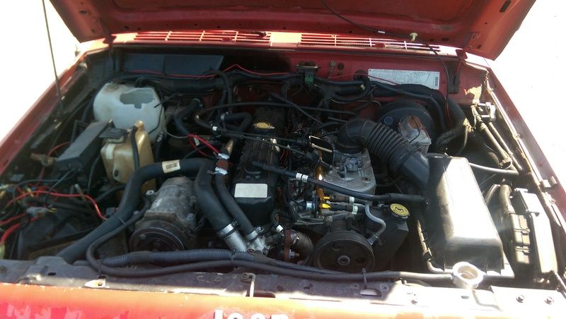

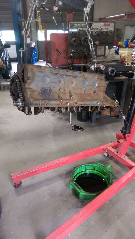

Donor's in the shop.
Couple hours of teardown.

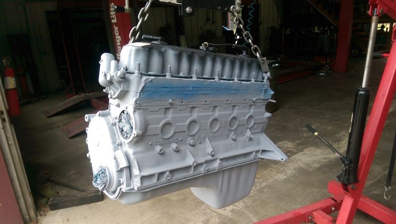

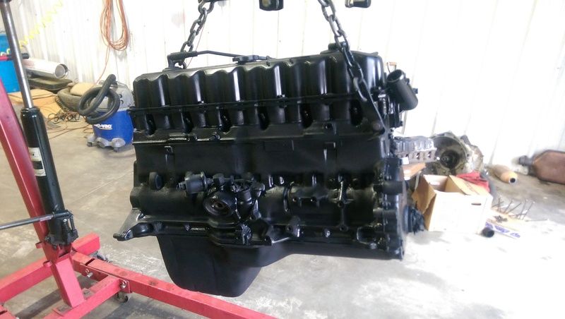

Put in a few hours today.
Head on, new lifters in. New oil pan gasket and timing cover gasket, crank seal.
Primed.
And painted. I originally wanted to go with a different color, but black just fits everything.
This engine is a Jasper Reman with 26k miles out of a 92 Jeep Comanche. Current setup is 4.0 HO block bored .060 over, 7120 HO Head (mostly new, only 5k miles on it from Dover Heads in Atlanta), 01 intake manifold, Comp Cams custom grind (mild torque cam), and an aftermarket header of unknown origins,

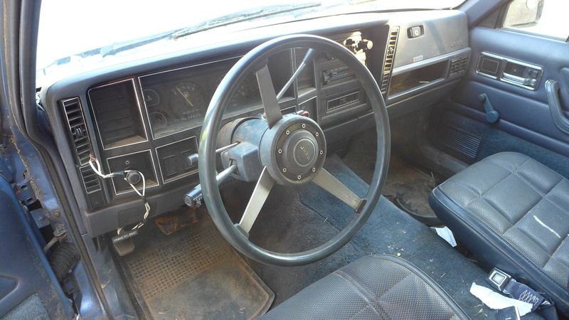

Interior stripped
Farewell, Renix
And none too soon.
And back outside. Not bad for a day's work.

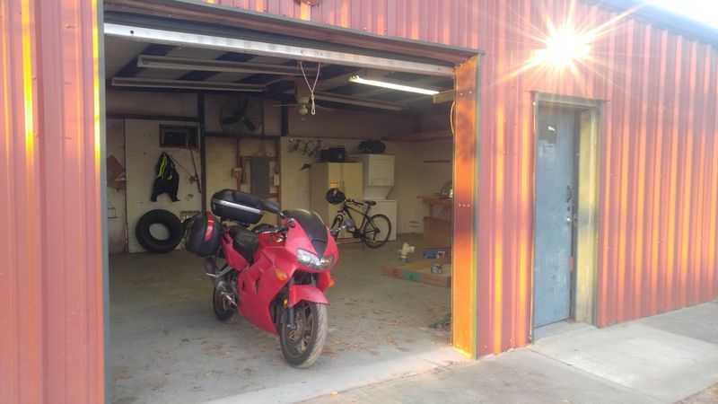

Wow, it's been forever. Things have been crazy, I bought a repo house that needed a decent amount of work, but now I have an air conditioned shop to shove my projects in.
In the meantime, the Comanche has been totally ignored. I hate it, but working plumbing trumps MJ.
I did do some thorough cleaning of the engine bay and reinstalled the gearbox and new IRO spacer.
