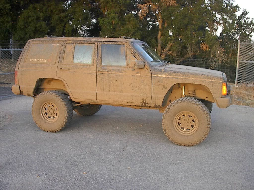

i personally love mine. i had a Rubicon 3.5" superflex but i switched it out for the Rustys 4.5" with full packs and i love it. but i did have the experiance with the Leafs not wanting to go all the way accrost to the frame and shackel and what i ended up doing was just putting a jack underneath the leafs and jacking it up to make it "stretch" out to the mounts. but overall i love the lift, but i do agree with MAYBE some better shocks but i can live with mine im used to em. and also the Kit gets actually about 5.5" of lift. but do put a spacer in front cause it sits a little nose heavy. heres a pic of mine with 33x12.5's
how does it get 5.5

Posts: 209
Brand new equipment possibly. I have the 3.5 RE full pack with Monotubes and have netted just a bit of 4".
