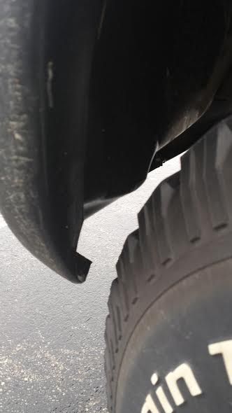

I got the full leaf packs for mine. My old one's were shot and needed cut out. Not sure if there poly or rubber bushings. After about 6 months and 5000 miles it hasn't settled at all. Currently I'm running WJ lower control arms but I'll prob switch to tubes. At the current lift height I only have about an inch of droop before they bottom out on the lower front shock mount.
While turning I had a lot of rubbing from my 31"s so just minor fender flare trimming was needed. Aftermarket flares shouldn't rub at all.
