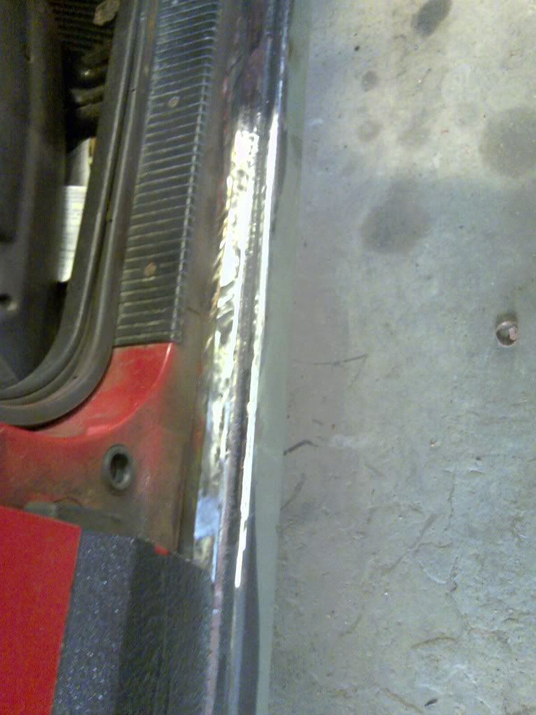

raypla
Location: Troy
Posts: 383
This
looks like this
Moisture gets up in there behind the sheet metal and slowly rots it away, from the inside out. So look out.
The replacement isn't that big of a deal but time and material consuming.
